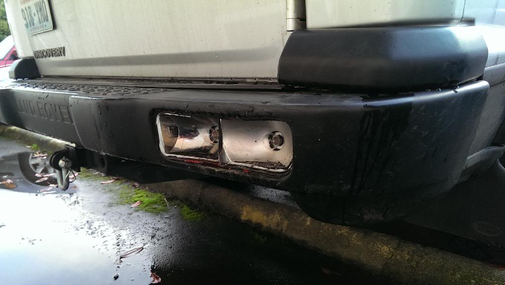

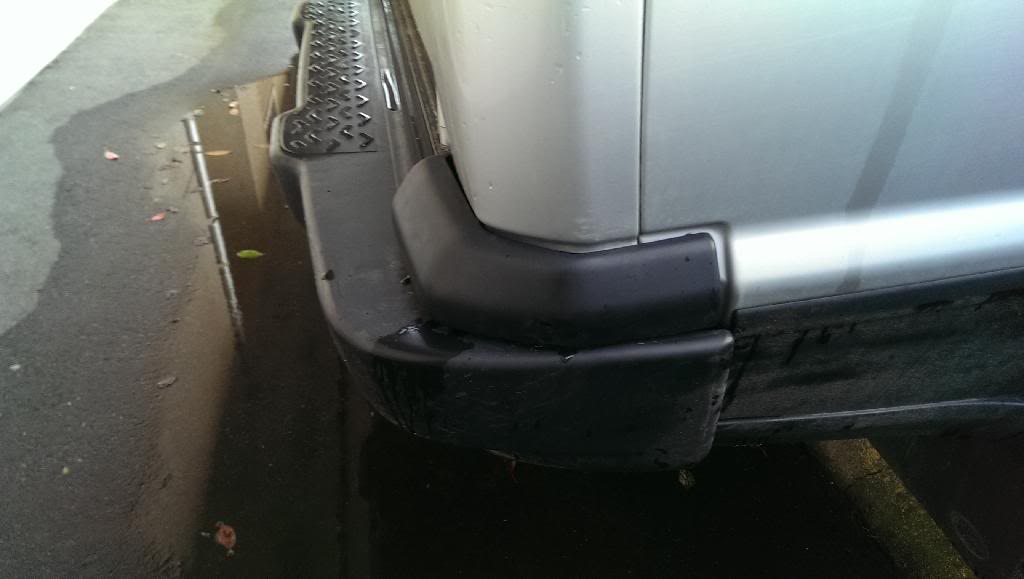

I got into a minor accident on Saturday up at the ski areas in the mountains outside seattle.
basically it was icy and snowing and stopped at a intersection behind several cars and a escalade slide into the back of us. basically because my truck is lifted his headlight,fender,grill was the same or similar height to my rear bumper. so the passenger side rear bumper was pushed in about an inch and the back up/rear fog light lens and housing was mashed.
the bumper is now kind of lose fitting so I assume there is some sort of crash or crush structure mounting the bumper to the frame?
the goal is to get the pay out from the escalade guys insurance and use it to upgrade to a steel rear, but I wanted to know if I need to replace any structure under the stock rear bumper or if it is something that gets ditched when swapping to a steel unit.
thanks for the help and if anyone has pics of a swap they did and shows the truck without the rear bumper and what pieces are under it, would be very helpful.
thanks
sloppy

Plastic...plastic is the structure that mounts to the rear of the chassis

it did sound rather crunchy under there when I was moving the bumper back and forth.
is that plastic needed or have to be replaced to use a new steel unit?

It's like 4 bolts or so, get underneath and you'll see them. They're at the left and right of the bumper.

Pull the fog lights out and you will see the bolts.
