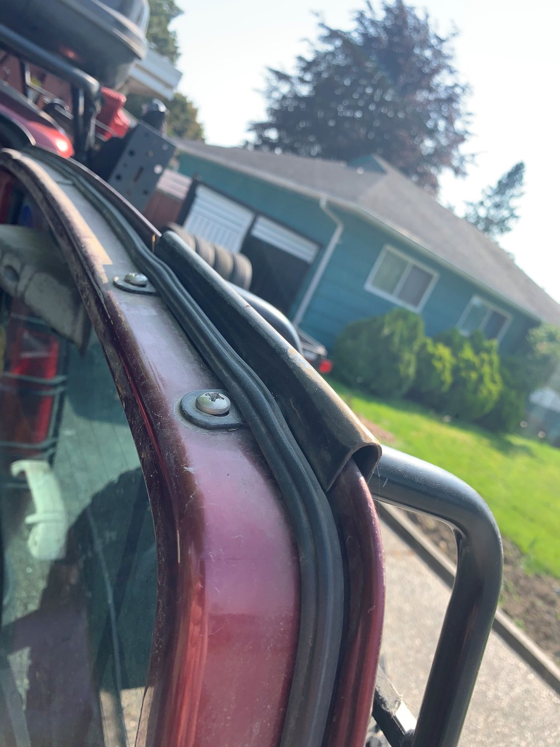

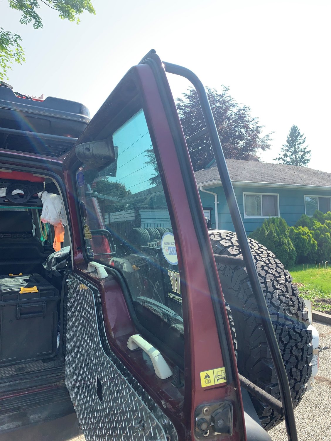

It happened to me in the past.. I bought a rubber trim strip with adhesive, and mounted it on the top part of the door. All the leaks went away. Let me get a picture for you.

For me the fix was to adjust the striker to pull the cargo door in closer to the body.
