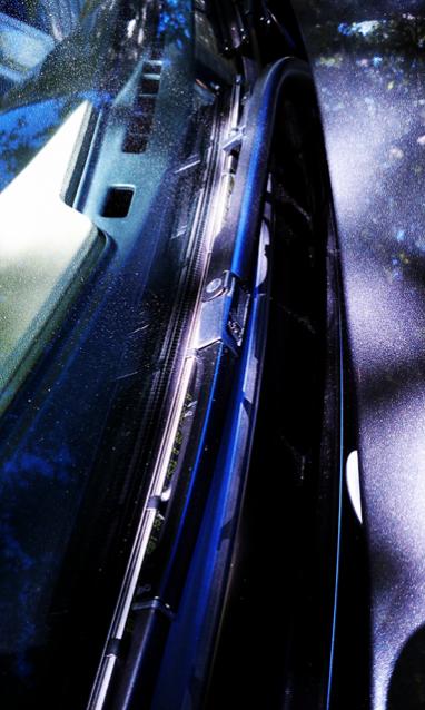

Looked like the ones that came off but the rubber blade looks like a better quality. They fit perfect. The fronts at least. I'll get pics and post tonight.

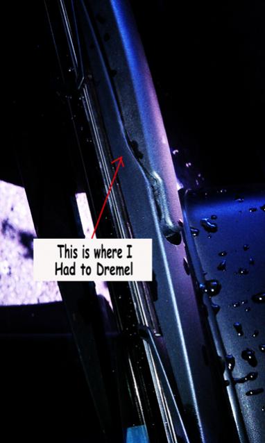

The pics.

i got a regular Anco rear blade for mine, i think 13" or 14", snaps right in, you just need to put the frame on the bench grinder to match the contour of the old arm so it sits flat, took under a minute to match the contour. just trace the old one on the new one

You guys are funny : "snaps right in, after using a dremel tool or grinder to modify it"
The theme is that you CANNOT buy over the counter wiper blades and expect them to pop in, you WILL have to make some sort of modification for them to work.
