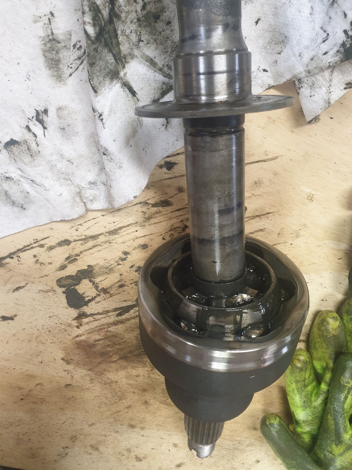

So... I decided to reboot and regrease my cv joints since I had just disassembled the front end while replacing ball joints, and installed poly bushings, end links, and new track rod and drag links... My disco is an 02, and I've owned her since 05. To my knowledge the cv's have never been serviced so I figured, I have it all apart now, might as well do it.
Got the first hub off.
​​​​Pulled the half shaft.
Pulled the hub off... No problem thx to a claw puller.
My problem is that here I'm at the limit of my knowledge.
RAVE 54-11 #5 states "Using a suitable drift against the inner part of the joint, remove joint from shaft."
Anyone willing to expound on that process a bit??
I'v looked around a bit, and I see some on the internet swapping out the half shaft w/ a new one, but can't find a demo of a proper reboot where the CV is separated from the shaft.
Any suggestions will be a great help!
Thanks
Cut the old boot off, and wiped the grease out of the way... Honestly... It all looked fine

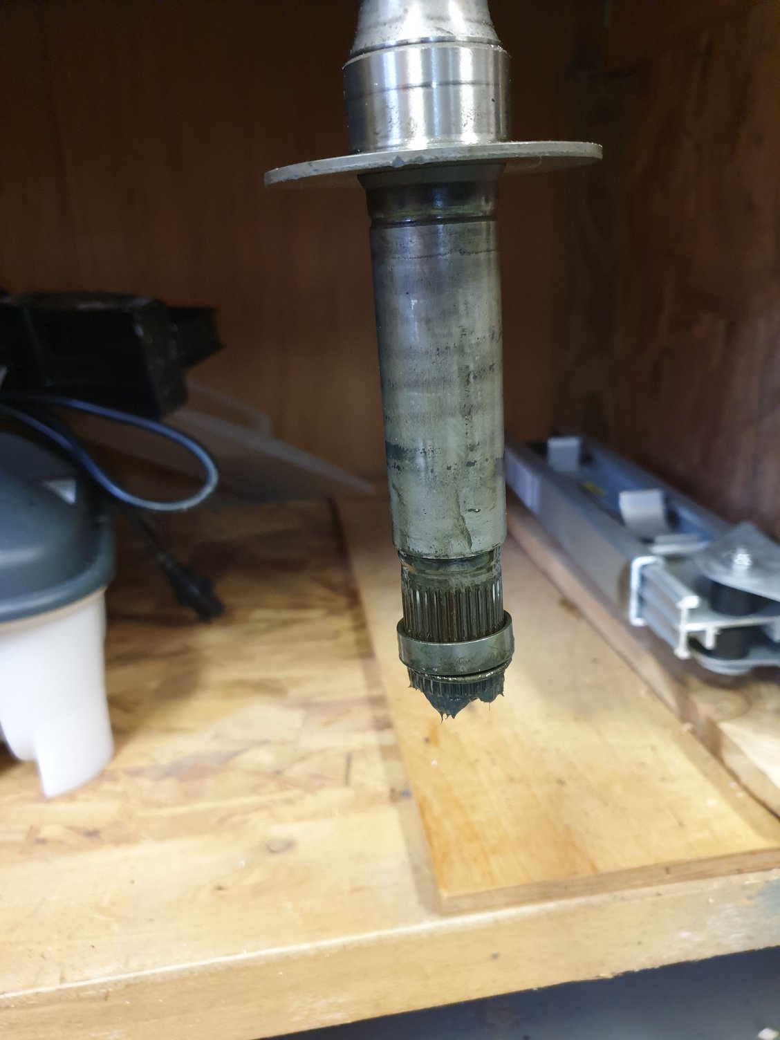

The CV joint separates from the axle, and the little 'hat' (part that goes into the seal) also comes of the axle....using something like a split plate to pass the axle through then close around axle, then knock the 'hat' off, or the CV joint...think it's just a spring clip inside the CV joint....

So I just hammer it off with like a hand sledge until the circlip surrenders?
Yeah I know, $80 seems appealing now, but the shaft and cv itself is (seems) fine. splines are all well formed, not too much visible wear, still nice tight fit to the hub, just thought it could use new grease. Pitty there's not a 1 way valve on the boot.
Ok, I'll try putting it in a vice and knocking it off in the morning.

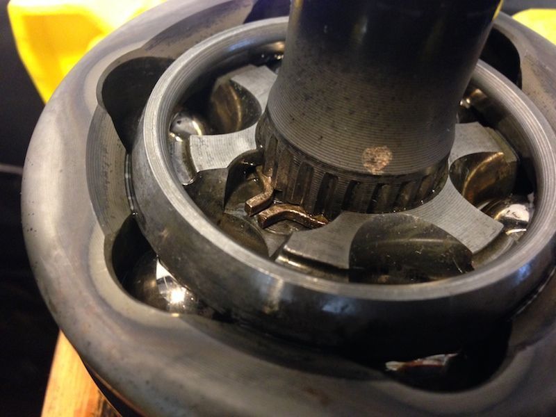

HI before you just knock it off check the shaft for a circlip inside the ball cage
shaft are sometimes locked in place like this not they type you can just knock off, or just spring snap washer you can knock out

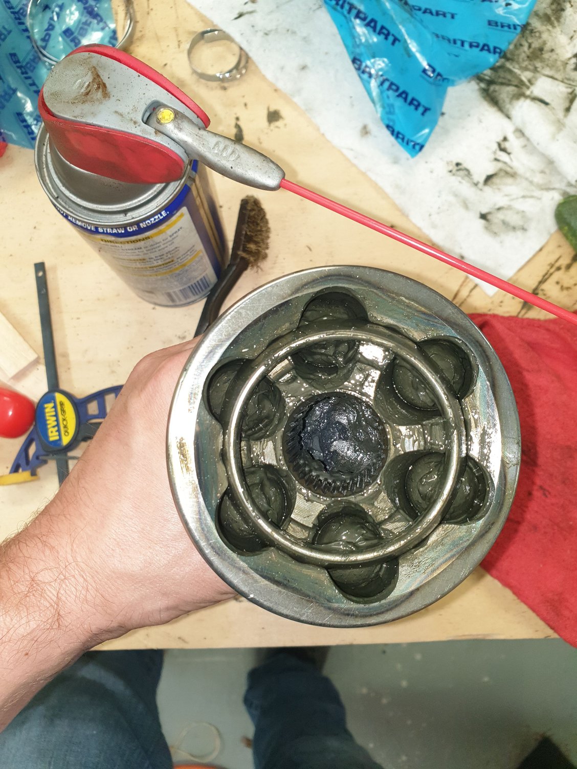

Ok, so the retaining clip is just a split ring.
I used a drift chisel against the inner flat of the cv joint just past the spaser. Use a hand sledge and a med - light hit from about 12"-18" of swing... Popped right out.
Oh... Clamp the shaft in a vice first, and put something soft on the floor to break the fall.
Otherwise the job was Very easy, and only costs $24!
Would recommend this job over replacing... Assuming your joint and splines are all in good shape.

For sure... Mostly cleaning the old grease out.
The boot kit I got (from AB) has the new boot, inner and outer securing rings, a new split retaining ring and a sachet of grease. Just loose fit the boot. Squeeze the grease in, secure and done.
Having a quarter roll of paper towels on hand is good too.
