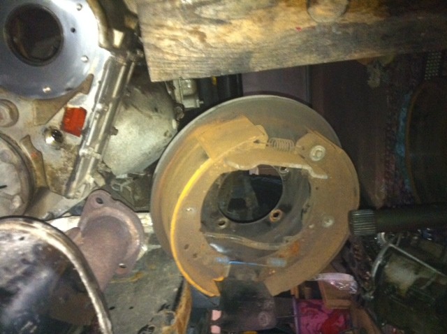

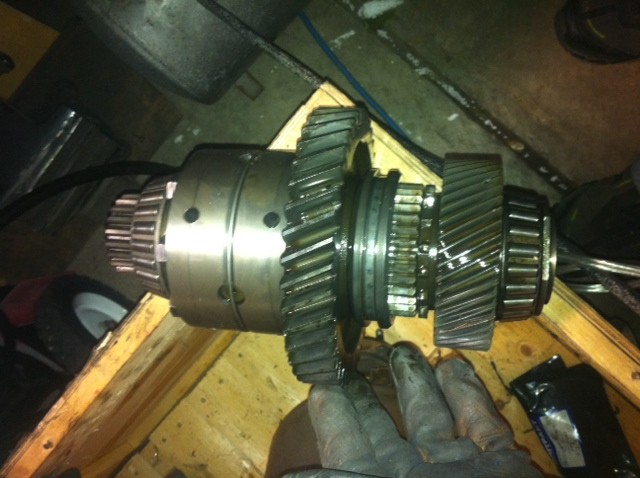

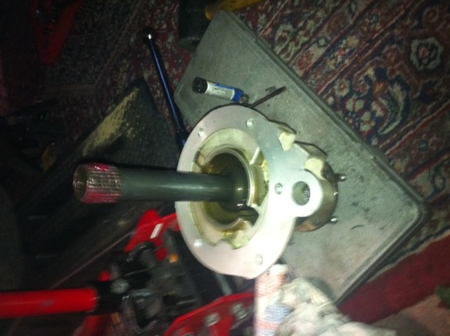

After removing the Y pipe front prop shaft and both cross braces. I was got the front output housing removed. Then I was stumped for a full day because the diff gears would not come forward TO SAVE MY LIFe. I got help from therealdiscomike on the forum. I ended up removing the rear output and prop shaft. That did the trick and I got the gear to come out. Then all I had to do was hook every thing up. Hooked up the D1 shifter.

Front Output inspection plate cleaned and ready to seal.
Front diff finally removed. Really clean inside. I reused my Royal Purple, less than a year old. Not a spec of metal inside the case. Sweet.
Rear output removed to get the front output to move forward.

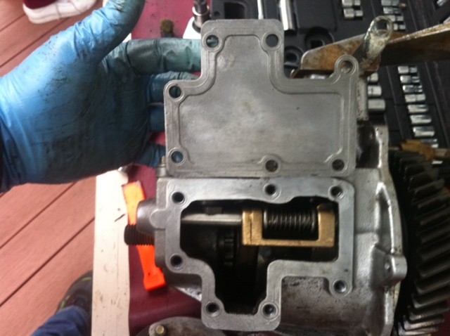

Rear view of T/C case with E-Brake hanging. Only took another 30 min to get this off.

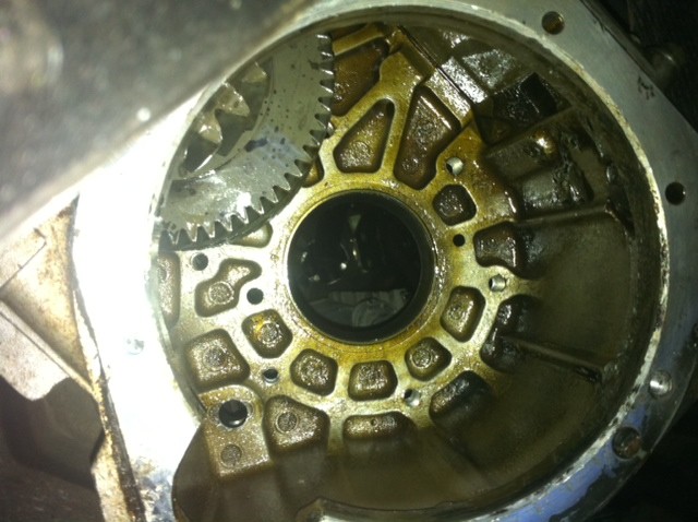

03 diff out. Holy crap I thought it would never come out.

From all I have heard the front output is different from a D1. After I removed the rear output I was able to jiggle the front output and remove it. You do need to remove the detent ball too. That may be your hold up. right there.
