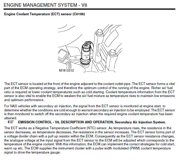

The SAI activation comes from the regular coolant temp sensor.
See here:
Remove/disable SAI?-sai-uses-ect.jpg

Interesting. So the fact that the listings for the radiator differentiate between SAI and non-SAI is actually not directly related to the SAI? The inclusion of the second sensor in the radiator just happens to coincide with the introduction of SAI? Weird.

In the previous posts, that sensor in the radiator was discussed. It has nothing to do with the SAI. It is used by the ECU to determine if the thermostat has failed so it will give you a code if it isn't used.
