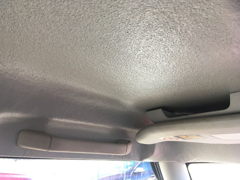

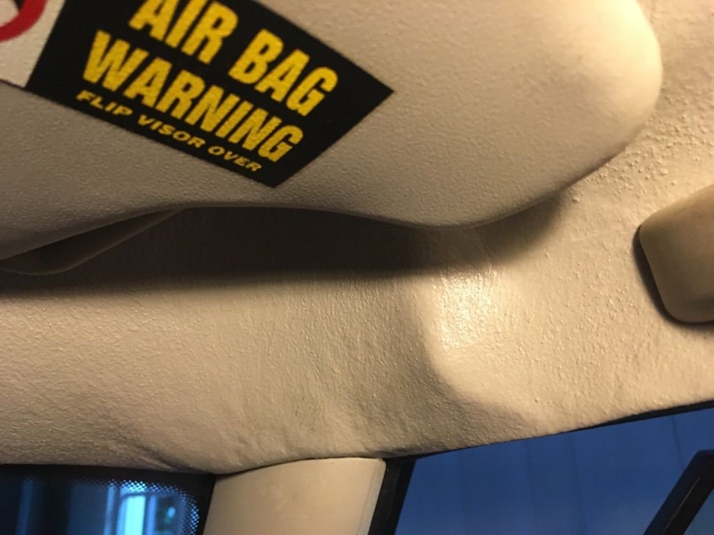

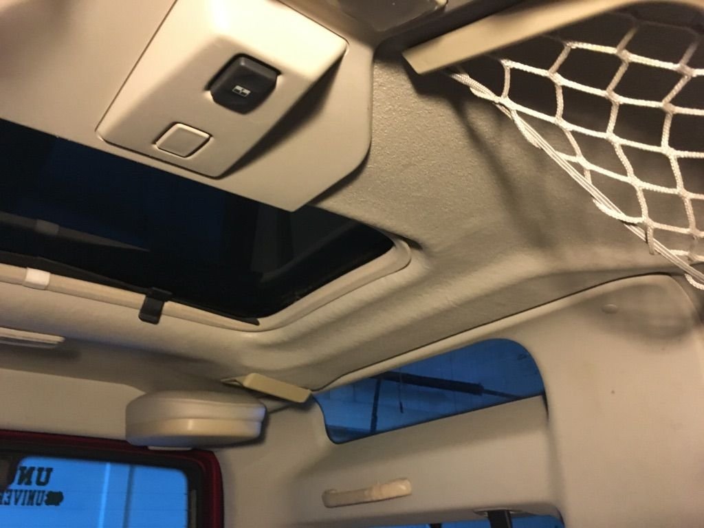

I regularly weigh in on headliner threads to advocate for stripping and painting vs. new fabric, but I've learned that not all DIIs have the fiberglass shell with the nice pebbly surface that makes painting recommended. I've learned that some have some sort of "softer" shell where painting may not work as well. That may be the '03-'04 facelift trucks; I don't know for sure.
The reasons I advocate painting is that it looks great and since there is no fabric it will never, ever sag again.
It's not the adhesive that fails causing the headliner to sag. It's the thin layer of foam between the fabric and the shell that turns to dust as it ages.
When I stripped and painted the headliner from my truck nearly 14 years ago, after pulling off the fabric I used a stiff brush to remove as much of the foam as possible. I next vacuumed the surface, and then used a brush and denatured alcohol to remove the old adhesive, followed by another pass or two with denatured alcohol and rags.
Once I was satisfied the shell was clean, I primed the surface with KILZ and then applied two coats of a good exterior latex. I took a piece of the old fabric to The Home Depot and the woman in the paint department matched the color very well. The interior of my truck is Bahama Beige. I've included a pic of the paint "formula" for my truck. I used a 4" roller for most of the surface and a small brush in the corners where the roller wouldn't work.
After all these years I remain very, very happy with the result.
