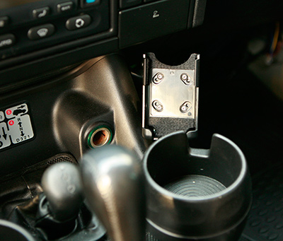

I upgraded my radio a few years back when I got my 03 so there may be newer technology but I am happy with how my system works and I did it all myself except removing the old stock radio which seemed to be stuck and I got the Best Buy tech to help me out.
I went with a Alpine unit that had optional modules for Sirius, an iPod or iPhone and HD radio. I did not opt for a CD changer that would hold several CDs, my LR did not come with the one under the passenger seat and I have no problem with swapping out a CD after it plays. I had to get a plug interface to connect the new radio to the LR radio harness and I routed the wire for the satellite antenna behind the instrument cluster and up the windshield trim on the drivers side out to the roof top just above the rubber gasket for the windscreen.
I also added a small power amp under the drivers seat to power the 12 inch Punch sub woofer I installed in the back where one of the cargo boxes was; I constructed a box to fit in the space and covered it with black leather like vinyl, it looks pretty good and ads that nice base sound. I found an adjustable little holder for my iPhone that I mounted just to the right of the shifter console and just routed the cable to it.
Here are some images:
