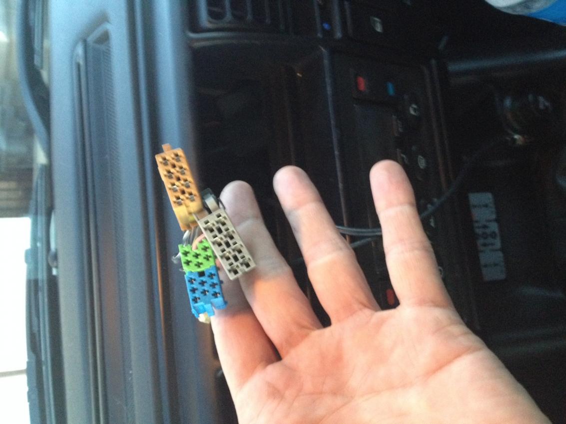

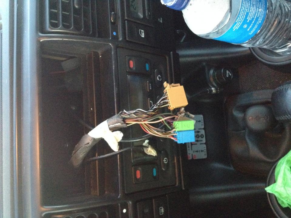

Hey guys. So i've been dealing with all these removing the factory stereo to a newer one....'problems' I've got my Metra harness, everything looks easy as pie, connect the wires, plug the harness, antenna cable and done. Yep, until you shift to reverse (or just out of park for that matter) then the brake/reverse light fuse blows. However, with the radio installed, I can press my brakes all I want and it does not pop the fuse, only when engaging the shifter. I've got some pics so you can see the wiring is ok.........any suggestions? voodoo water? Until tomorrow, with tomorrows new problems, thanks.

What year DII, and what fuse blows?
Also, can you shoot a better picture of the Main Cable showing the end? Maybe stretch it out so I can see all leads?

Not sure what year your D2 is but here's a guide for the 03-04 wiring. Check the note about the wiring being reversed from the Metra adapter. Do you know what number adapter you have? Also, check all of your wiring again. There is a speed sensor feed to the amp (#20). I suspect you are inadvertently delivering 12V to that line. I also strongly recommend using something other than wire nuts. They belong in houses which are stationary, not vehicles which are moving and subject to vibrations. 2003-2004 Land Rover Discovery with Harmon Kardon Wiring Information

here's the pics, nothing seems abnormal to me?

I'm sorry, I wasn't more clear. I meant this one. See if you can spread them out to show both ends and the connections.
