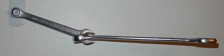

I use two 14mm wrenches (a 9/16 should work in a pinch) with another wrench acting as an extension. Google the two wrench trick.

The wrenches are possibly easier, but slower once you get the nuts broken loose.
