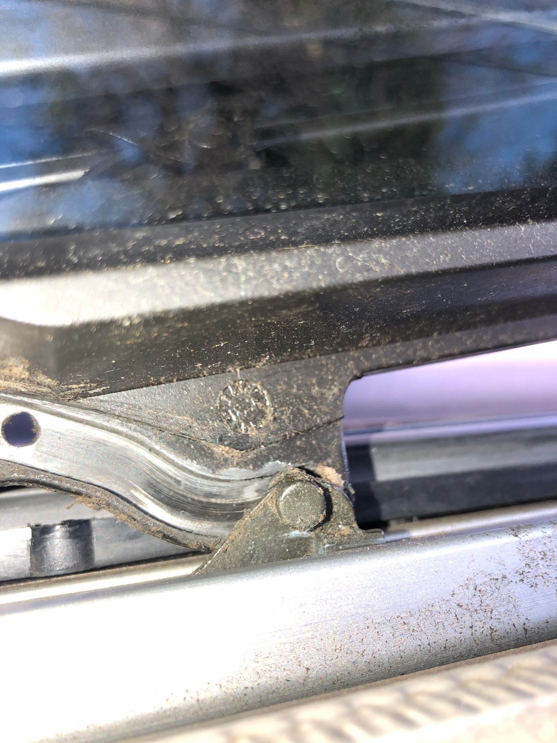

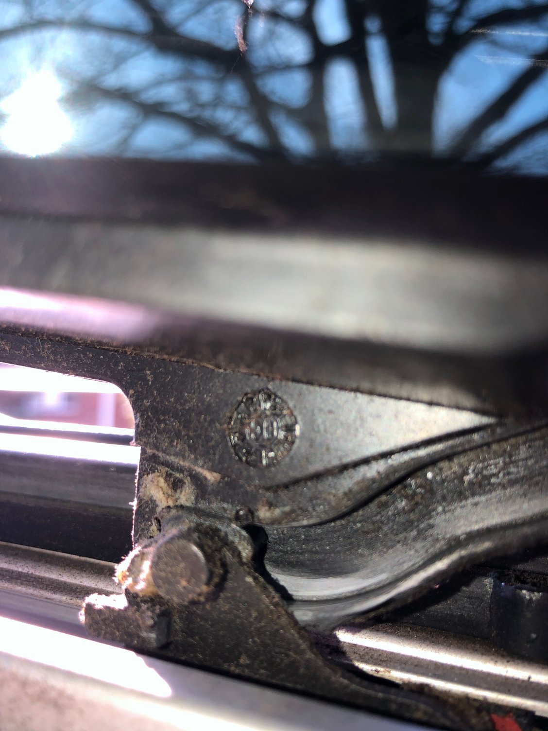

Hi Scott Did those work for you? I have a rattle too and I’m pretty sure it’s the same rattle you pointed out. You can mimic the rattle easily by jiggling the glass up and down when it’s in an open position. One of mine are missing. It looks like a square plastic piece though that runs along the wavy sunroof track just under the glass. The first pic is the one is the side showing the plastic guide thingy missing and the second pic is the side where it’s installed. Sorry for the dirt - hope it’s clear enough to see. Looks like the sunroof might need to be unbolted to fix.

Kalliste80 it's been several months and I think I can safely these replacements are working perfectly. No rattles and they seem like they are plenty sturdy. Plus, with the extras that came in the kit, I can always swap them out if they wear down, but I don't expect to have to.
My stock retainers were completely gone and it sounded like i was going to lose my sunroof just driving down my street what with how bad the rattling was. No more rattles for me, hope you do the same!

thanks so much! I’m ordering now
