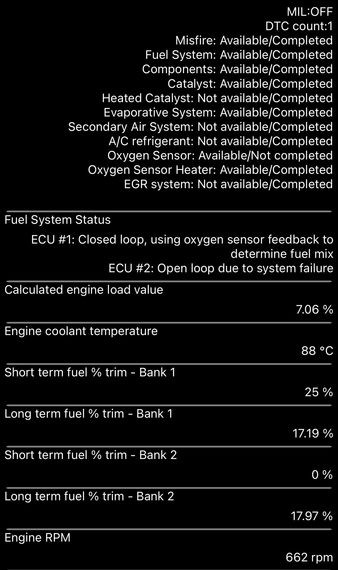

Also, when I'm driving, both ECUs are on closed loop, but at idle, the second ECU goes into open loop:
