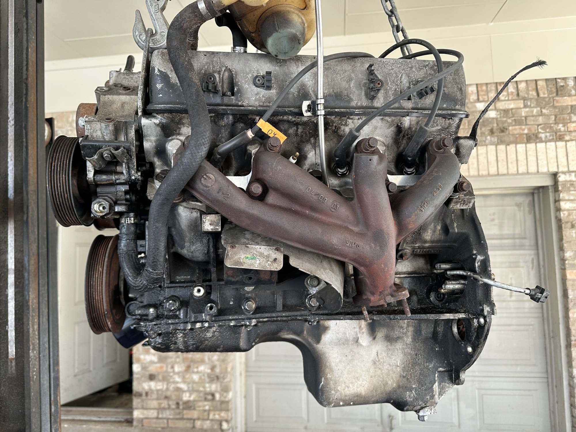

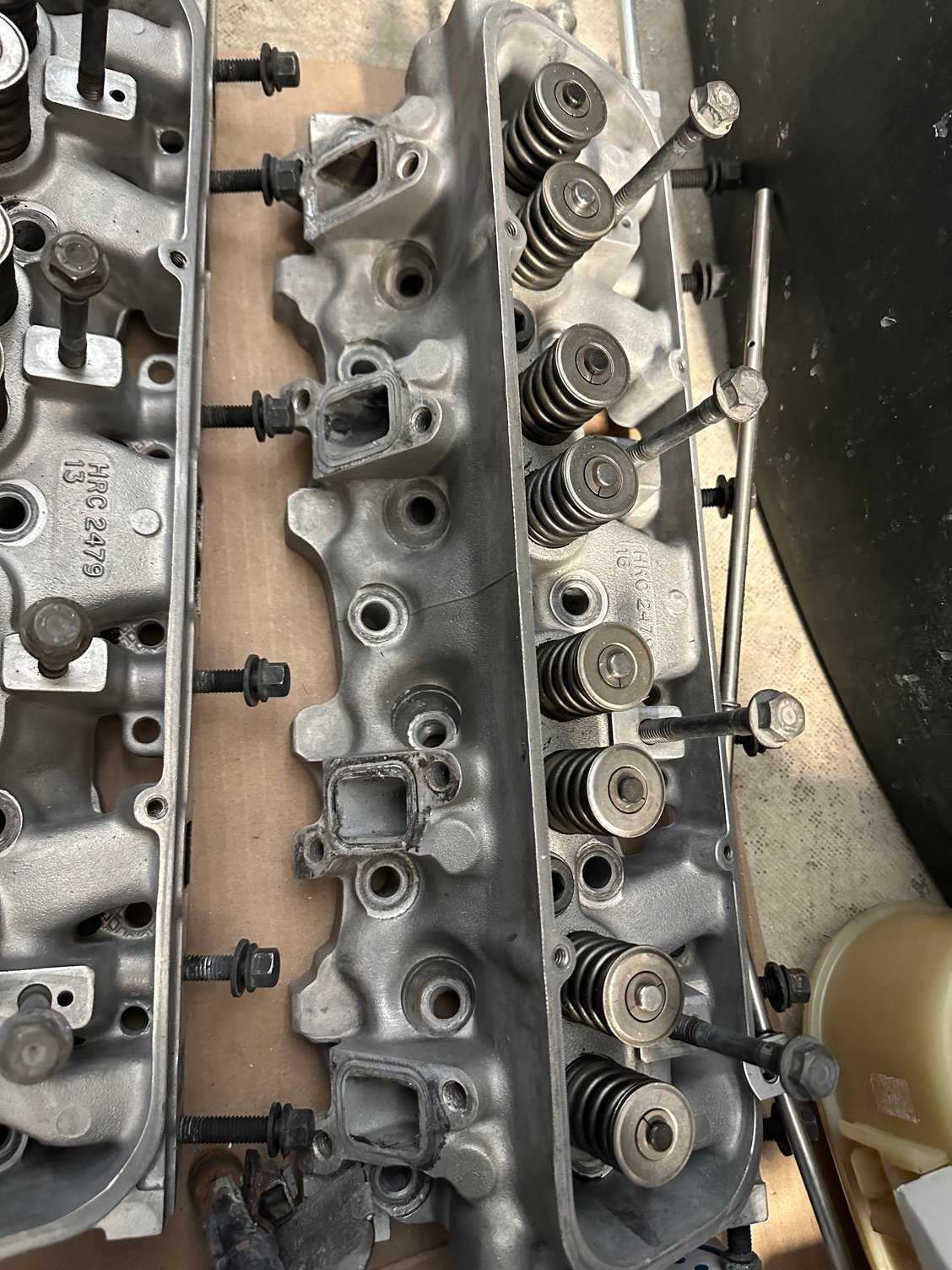

I recently purchased a 2004 SE. I have taken the entire truck apart. Going to be rebuilding almost everything. I took the engine out and tore it down, at that time I noticed the heads do not have SAI, but the truck has SAI pump and solenoid. How can I verify if the truck is SAI or not.

I bought it almost as seen in the last photo. So no I do not know about its running condition. I actually was not paying any attention to SAI when I bought it. In my mind they all have it. I only actually discovered now that there were some without, and that was because I pulled the heads and saw that they didn't machine the holes for it!

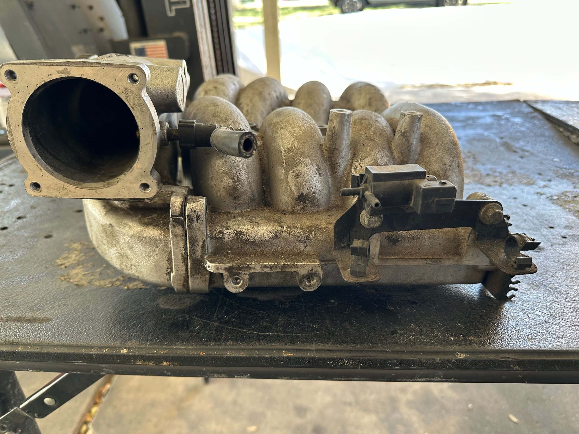

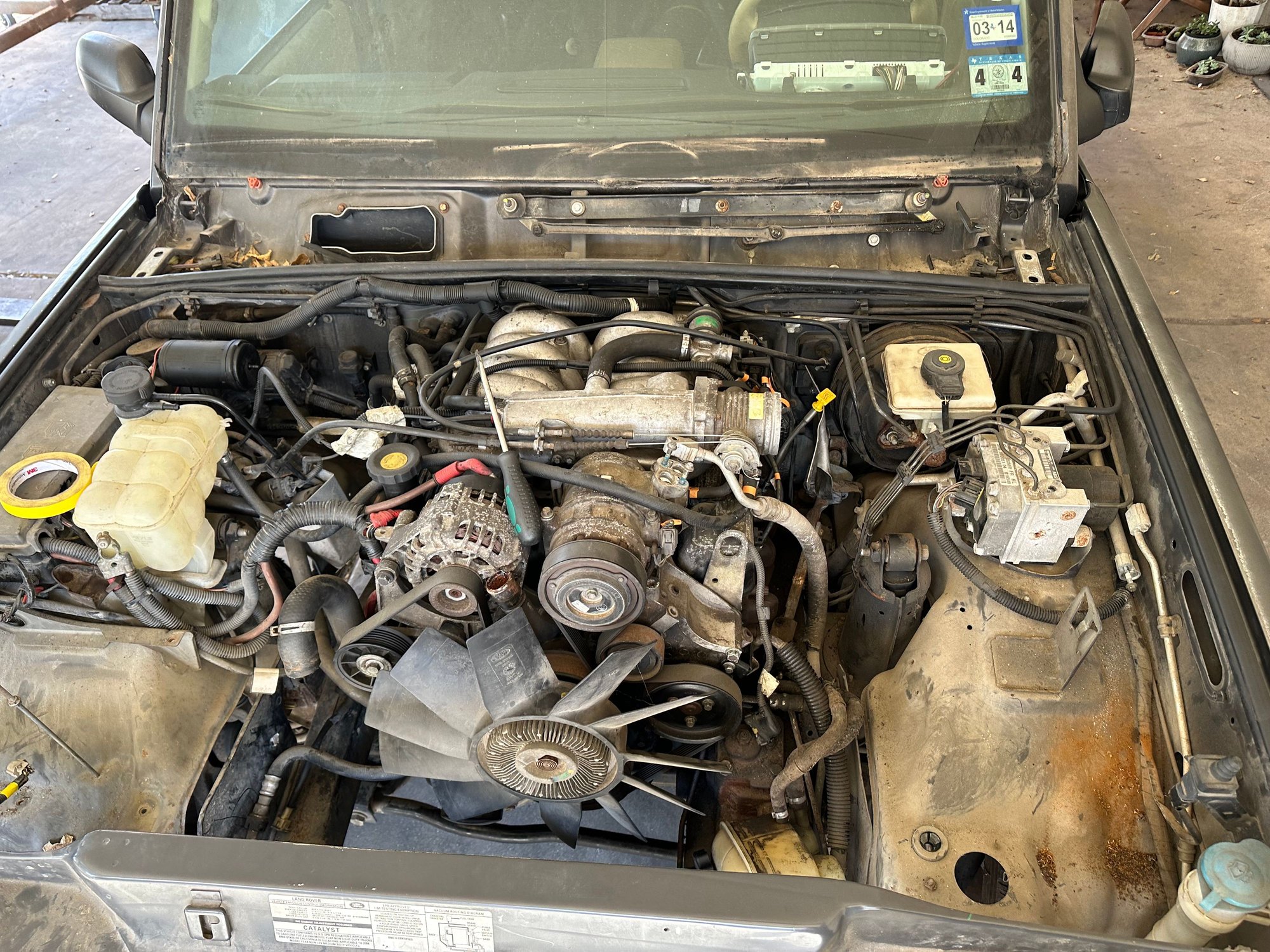

Your truck doesn't seem to have these SAI valves, the big round pots in the center of this picture, which are a large part of the system. You do seem to have the air pump in the far pass side corner of the engine bay. As LTS pointed out, it's certainly possible that someone removed parts of the system, including the heads with the ports that accept the tubes off the T pipe below the valve in this photo, but just doing that also creates collateral issues as he also mentions. The only way to completely remove SAI, no matter what parts have been taken off, it to address the fact that the ECU will be looking for SAI activity and will generate the associated codes if it doesn't. You can swap the truck's electronics from a non-SAI truck which would include the ECU, BCU, & cluster at minimum, or perhaps reprogram what's original to the the truck with a textbook or nanocom but that's outside of my experience. Swapping those parts would lead to a VIN mismatch which would likely show up at inspection time (AMHIK), but the bottom line here is that since you don't have the valves, you don't have a functioning SAI system. Those heads in your pic also do not seem to have the necessary ports either so it appears that some swappage has occurred.
