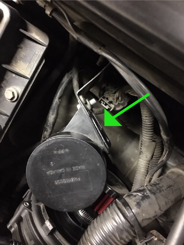

How did the K&N filter switch work out? any issues? if you have any pics still around on the mods to fit the pump motor onto the bracket so the K&N filter fit that would be very nice. thx

[CamelChad] If you still have these pics around, can you re-post them? I'm about to do this same mod....
thx.

No issues for me with the K&N filter on the SAI pump.
I take it off, wash it out, let it dry and reinstall.

your filter must have been replaced over the years. mine is so brittle just taking it out of the holder it was crumbling.

c
Juke's OG photo.

the second from last pic with the green arrow...that is pointing to the purge canister...correct? looky like you bent the mount for it back toward the engine bay fender...right?
thx for posting these...bit hesitant to mess with "stock" stuff....but gotta do it I guess.
