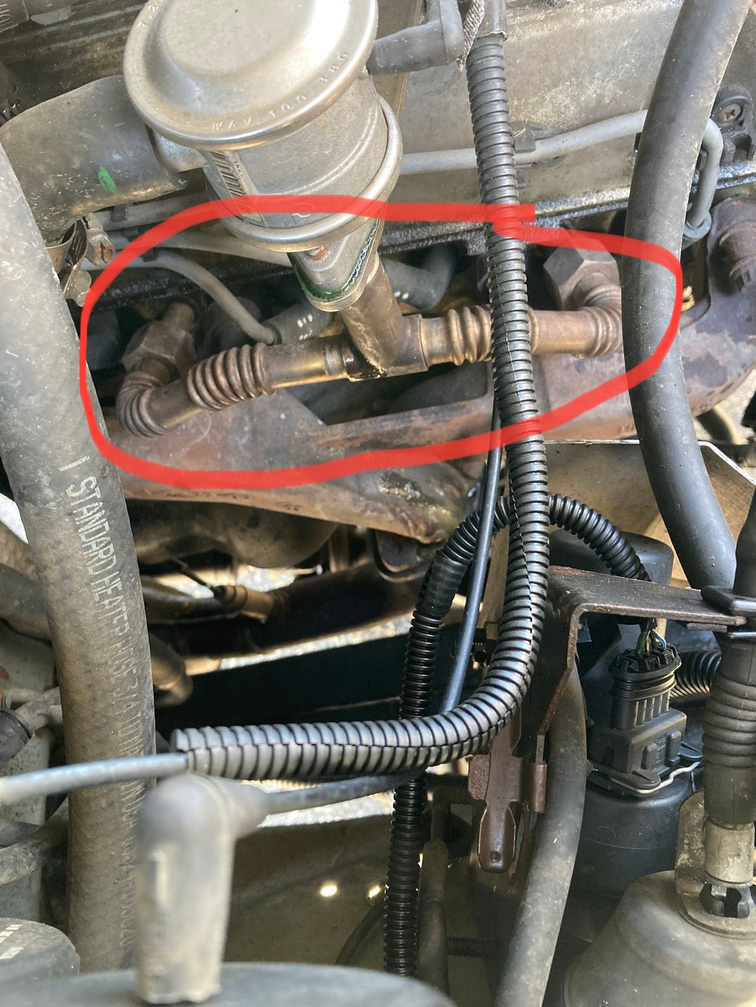

Passenger side of my 2004 Disco2 motor. I need to replace the brass looking T apparatus which leaks. What is this part called? I can find no diagrams or schematics which labels this part.

Secondary air pipes

And here is a diagram with the part numbers etc.
https://parts.jaguarlandroverclassic...nd/land-rover/
