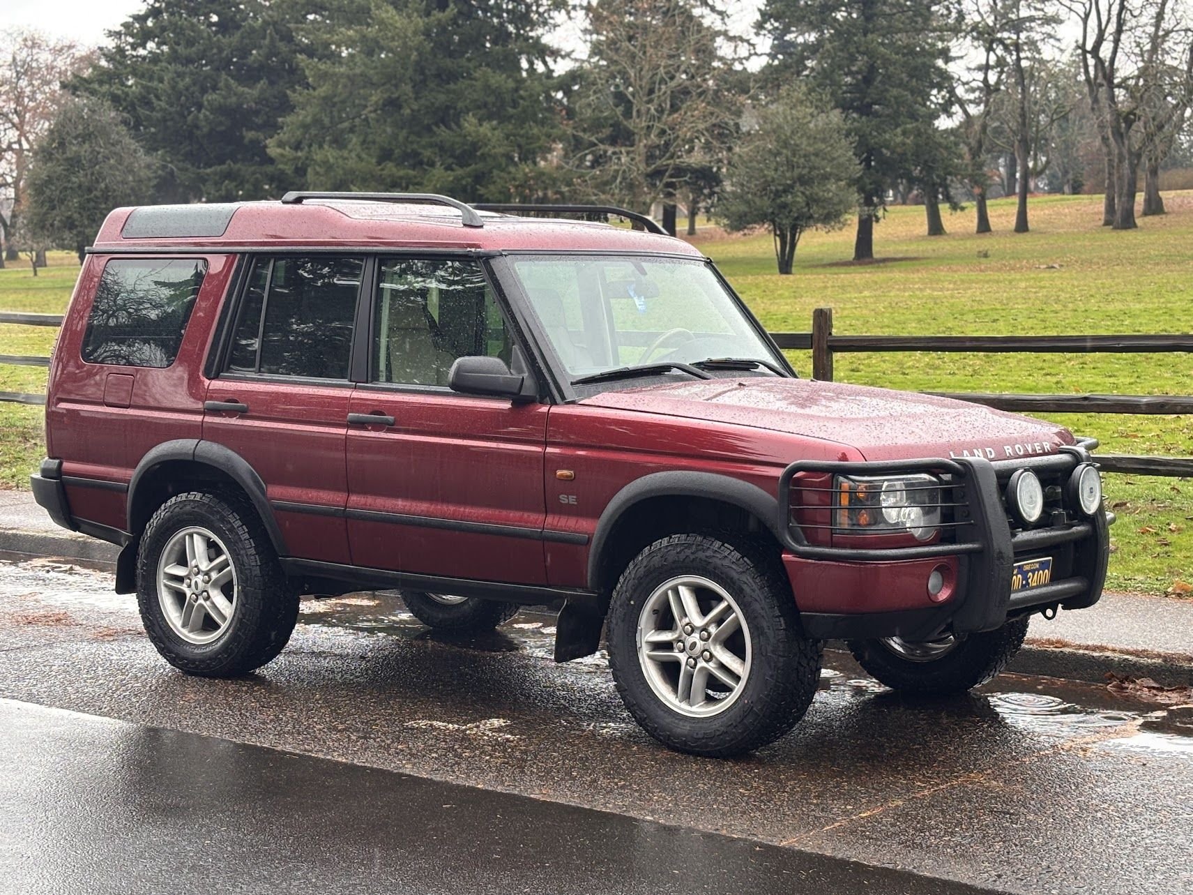

I replaced the existing shocks and put on a 2" lift using this Terrafirma kit from Atlantic British - I put on a new OME steering damper and it rides (and looks) so much better; however, it's a chunk of change to replace as well as put on new tires.
