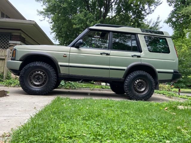

I just purchased a 2001 Disco II, going with TF 2" MD with stock 18's and 265/60/18 BFG AT's. This will be a light weekend wheeler/ bum around on the weekends rig for my wife and I, in north TX. 80% of the time this will be on pavement. Any suggestions on shocks would be greatly appreciated (ride quality over wheelin performance).
Options are TF118/9 that can come with the kit, Bilstein 5100 (assuming they fit) or OME (expensive, worth it?). I'd prefer to purchase from BAtlantic, but currently out of stock. Will likely buy from Lucky8, but have heard that they can take a long time to ship.
Also, Are there steering/brake line (ext) upgrades required on a 2" lift aside from spring and shocks?
Disco 5 drives like butter, 99' 3/4 ton burb drives like a horse drawn carriage and trying to find the right in between, as this is on solid axles.
Any and all feedback is greatly appreciated

Originally Posted by dswilly
I have the TerraFirm 2" MD set up here and have been happy with the ride quality. There is a stiff ride element to my set up but I blame the E rated tires, not the suspension. Overall very happy with it
nice looking Rig
