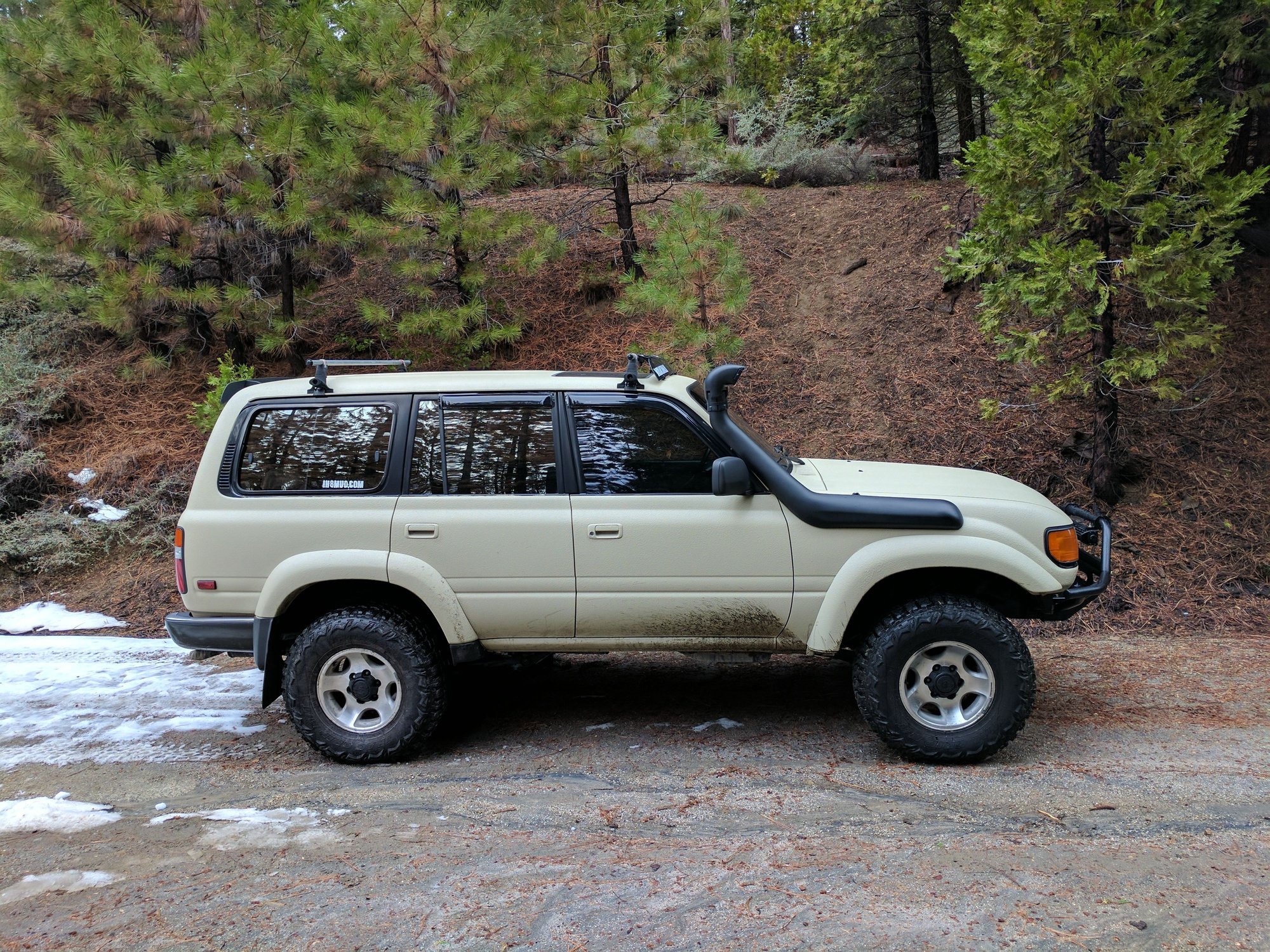

Mixing springs is very common with the 80 series Land Cruisers and am surprised not to see it with the Disco guys. On my 80 series I have OME heavy springs on the back and OME J springs on the front which is a tall version of the heavy. This gives me an even ride height using the different springs. OME makes a J for the rear but then the back ends up really high unless you have a ton of gear in the vehicle. You can do the same thing to maintain a level lift but get less overall lift by putting the heavy on the front and med on the back, and same again with med on the front and their HD stock replacement on the back.
'94, factory lockers and other goodies, it's for sale too
