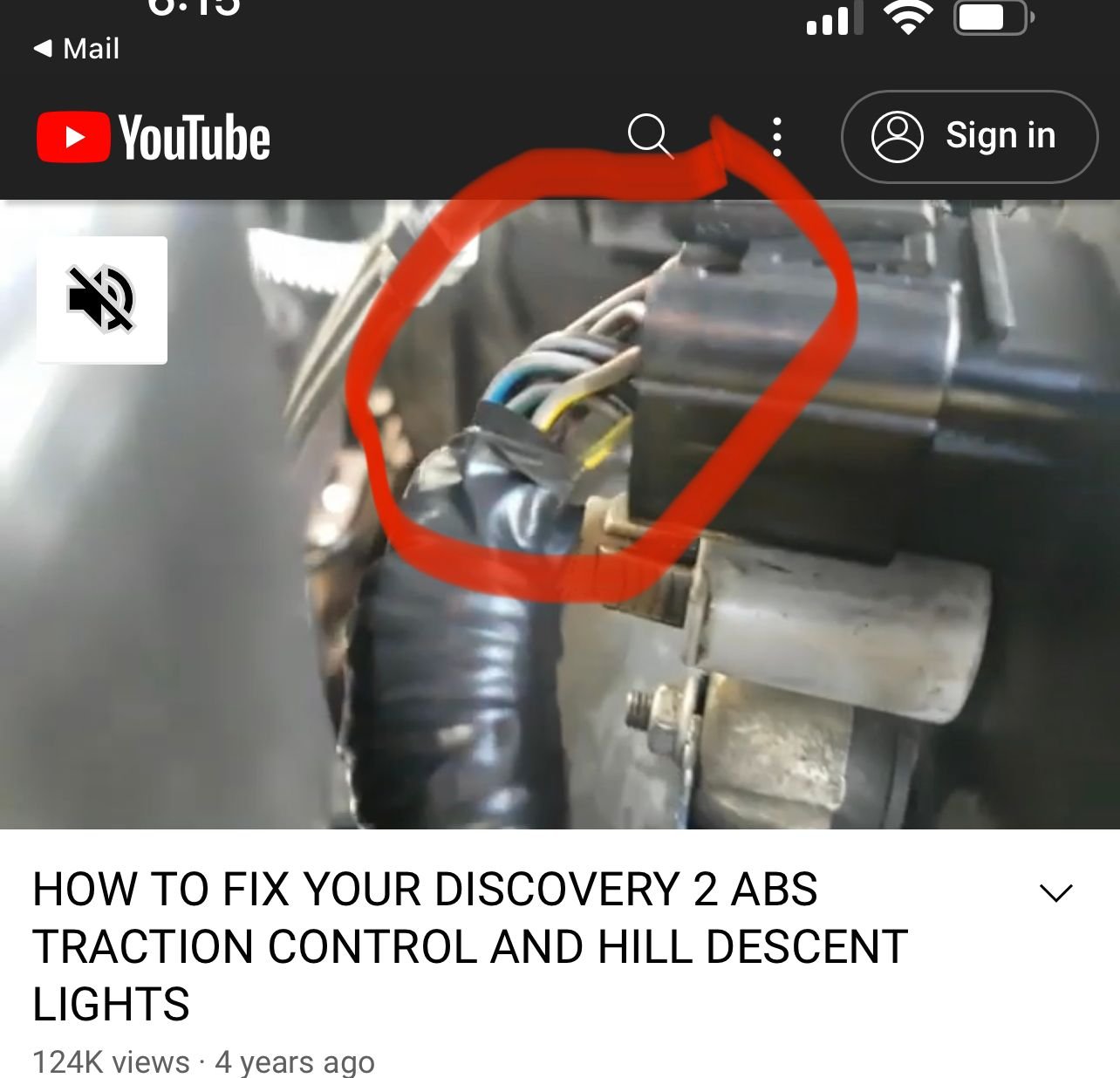

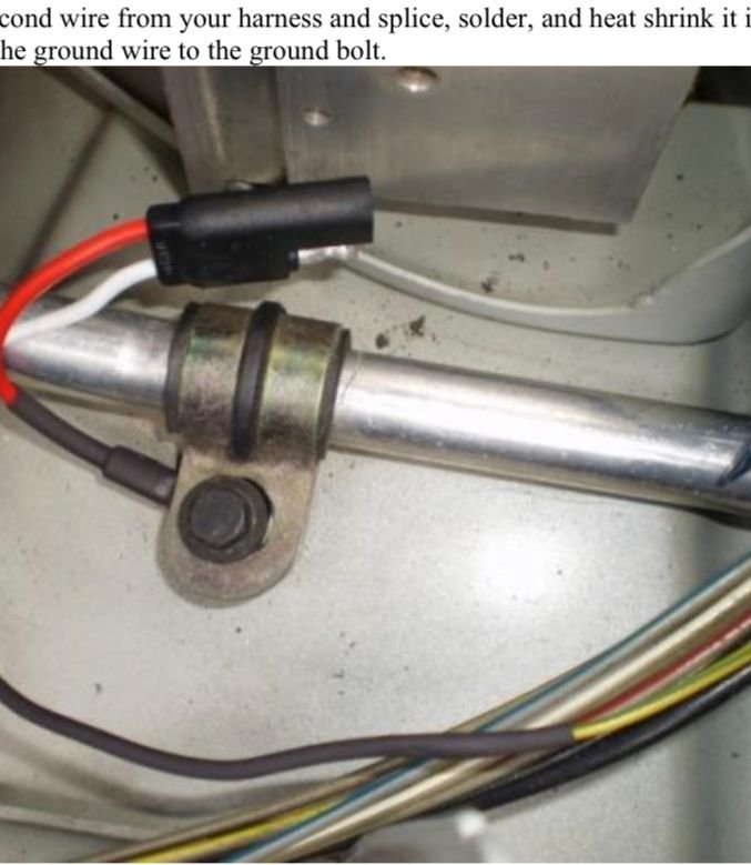

I think I may have just figured it out mere minutes after posting that question. It looks like it IS safe to cut the y/g and that you just need to splice the hot shuttle valve wire with the part of the y/g going IN TO the aluminum ABS box (no idea what the actual name is for that)
If I’m wrong, let me know so I don’t kill myself or someone else.
Thanks
video and pic I used for reference:
https://youtu.be/KM-tErPV3Pg?t=8m15s
Spliced wire into yellow-green

You splice into yellow/green wire side headed back to the SLABS unit. You DO NOT connect it to the side going to the Wabco unit.
Old Sep 15, 2022 | 08:17 AM
disco_nap's Avatar
Joined: Aug 2022
Posts: 77
Likes: 9
From: San Luis Obispo, CA
Phew. Thanks!
Based on that video I thought it it needed to be spliced into this side of the y/g.
