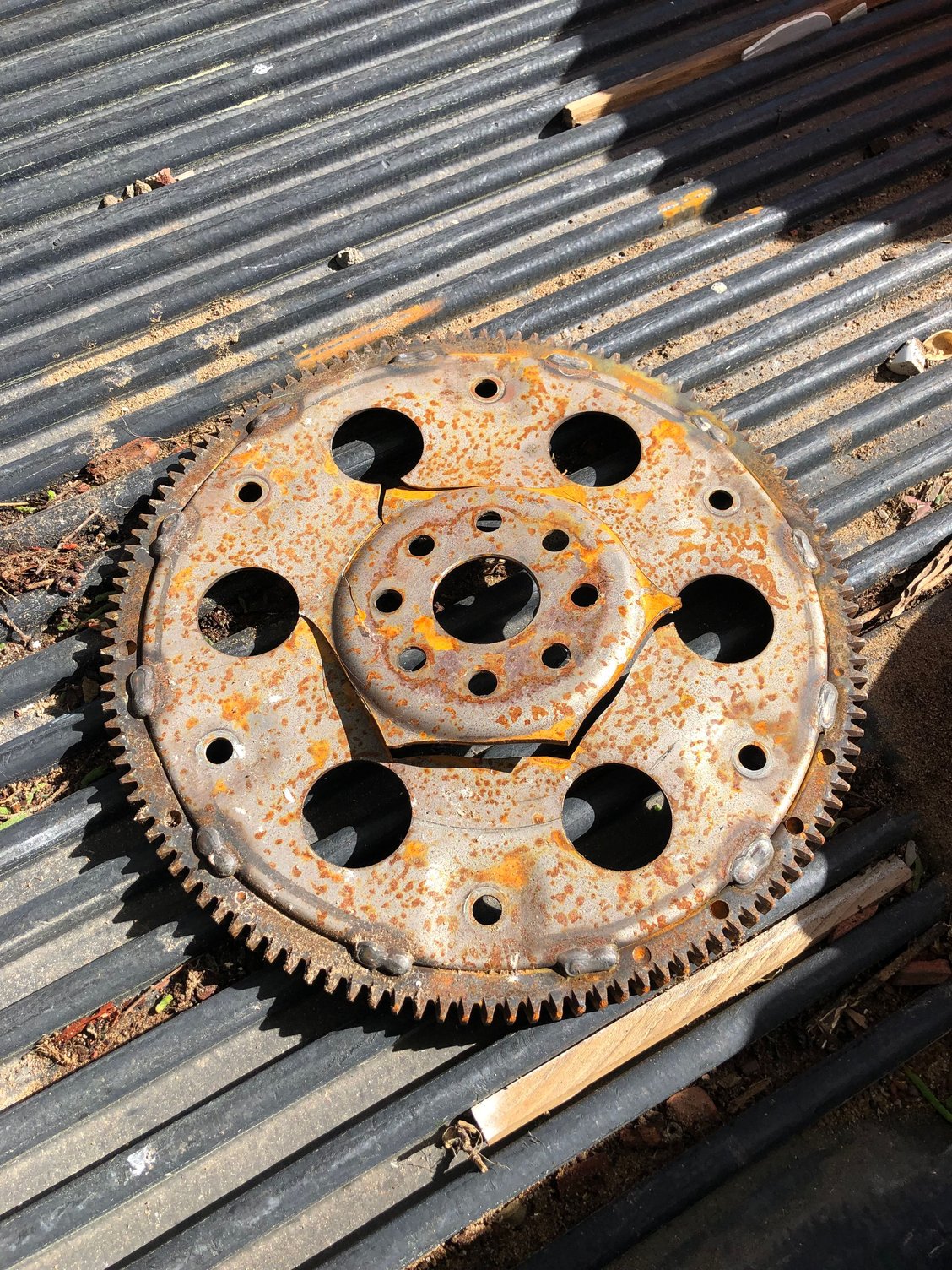

Hey all!
I'm getting a slight rattle sound coming from around the transmission-ish area when idling at accelerating. My first thought was, crap, the flex plate must be cracked or something, but that could be PTSD from that same issue I just wrapped up with my old Tacoma. My mind might be making me believe it’s something it’s not.
Heres a video that might be helpful? Listen for the slight rattle can noise on the first application of throttle.
And just for fun, here’s a photo of my tacoma’s flex plate... and a video of the sound it was making at this point...
