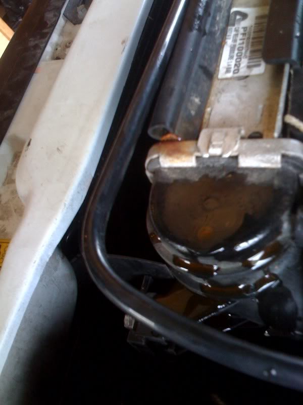

Second morning in a row that I've noticed a small spot of coolant on my driveway.I saw some fluid here last month and replaced the crappy LR hose clamps with new ones thinking that it was the issue but I think this may have not been my problem.
I examined the radiator from all angles top to bottom with a flash light and found that the leak appears to be coming from the top driver's side. The driveway has a slight slope sideways so the fluid seems to be dripping down to the bottom and running to the passenger side before hitting the ground. So I removed the upper fan shroud cover that is held in place by 4 phillips head plastic screws and then removed the 2 screws that hold the lower shrowd assembly to the top of the radiator. There was a small puddle of fluid under this part and I am wondering if the mounting screw actually goes into the radiator here, which would seem like a pretty dumb thing!
I am going clean and dry out the area and to try using RTV sealant when I put the shroud back on as my first solution but I hate band aid approaches. I have read where the hard plastic tube can crack and should be replaced with a rubber one but this is not where the leak is coming from, it is definately under the shroud where it is attached to the radiator.
Has anyone had this issue?

Found the culprit. In the late afternoon after a day of running around town and I was safely back in the driveway I went ahead and took out the screws to the upper fan shroud which exposes the area where I had seen fluid collecting. Sure enough some antifreeze water was there so I mopped it up and then, after 10 seconds or so the fluid stated to appear again and grow in size. Apparently I have a small crack that has developed there. Possible defect I figure but I just got a new radiator from AB Parts.
Now the question is moved towards R&R the radiator. It seems like there are 2 small machine bolts at the top right or left that attach the radiator
