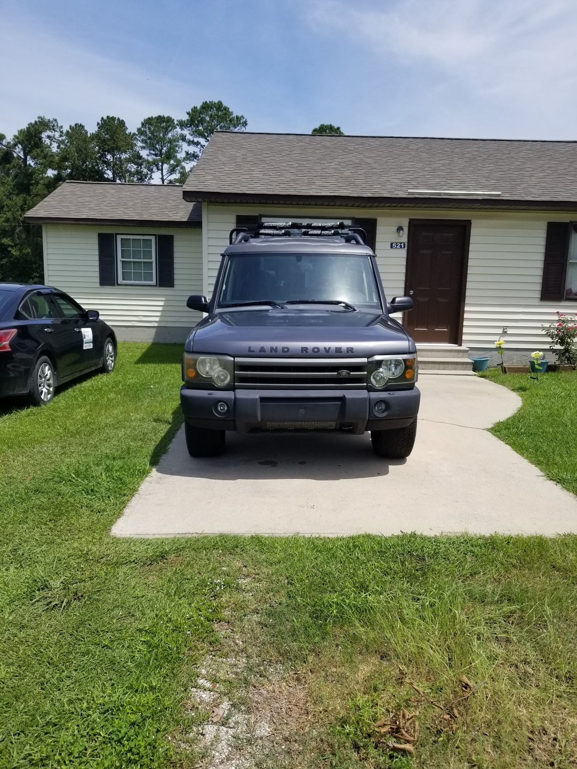

Ok guys so I have a cracked block for sure, I spoke to the LR mechanic that did the work on it for the PO and he confirmed that. Love when you dont get the whole story, not that I had not already been considering an engine swap but because I wasted hours testing and playing with it hoping it was something I could fix. Anyway, so now I have been reading on here about the various options, mainly a rebuilt 4.6 / 4.0 or going all out on the LS swap (what I really want to do). For Extinct and others that are well versed, are there any other options that I need to be aware of? Mainly I have seen some p38 swaps but what about newer LR engines or just any other options. I want to keep this build under $5k (well under would be great) and I cannot do the work myself now as I no longer have a garage or lift and my new job wont give me the time either. Thanks in advance yall!
She's worth saving!
