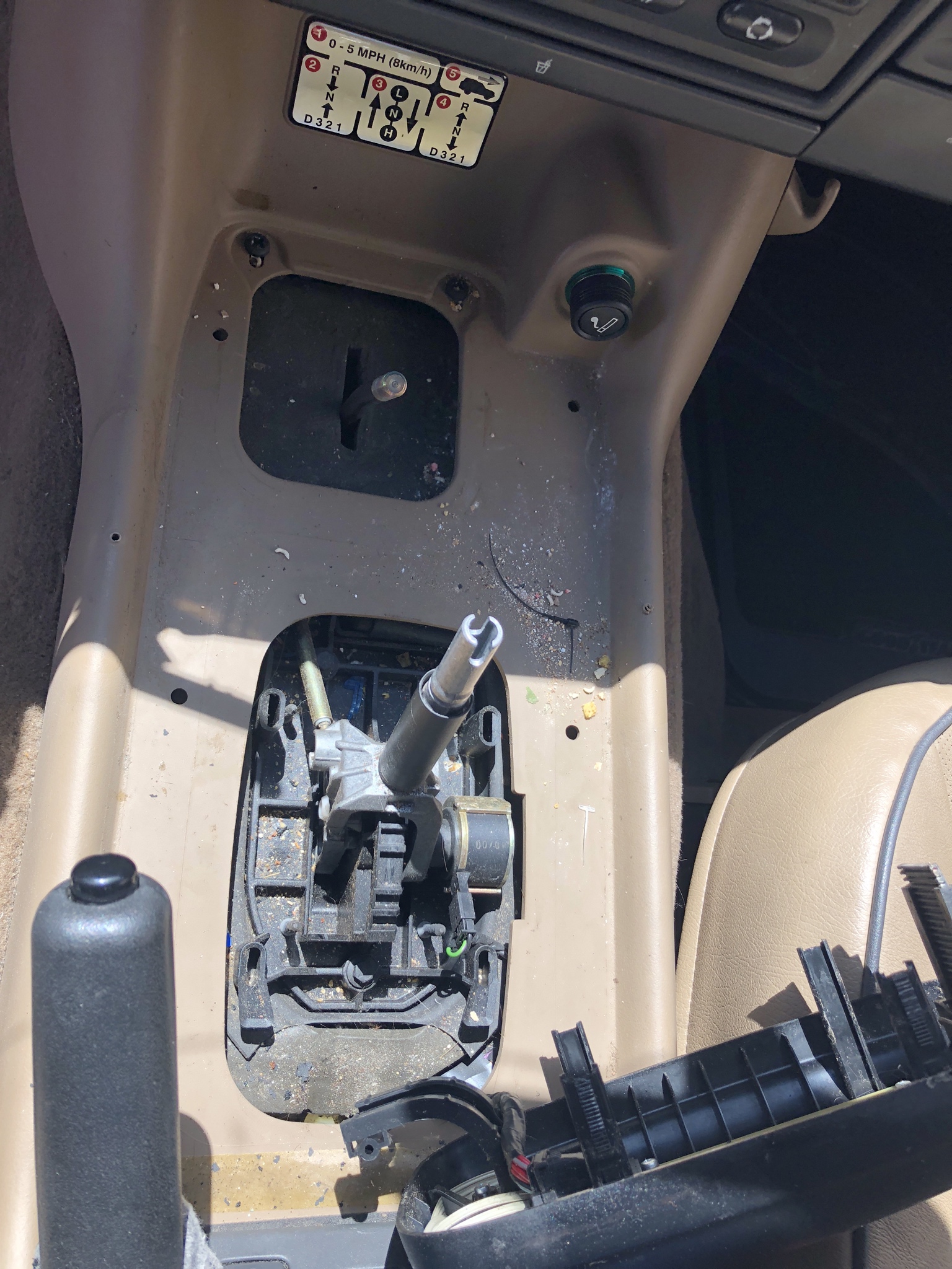

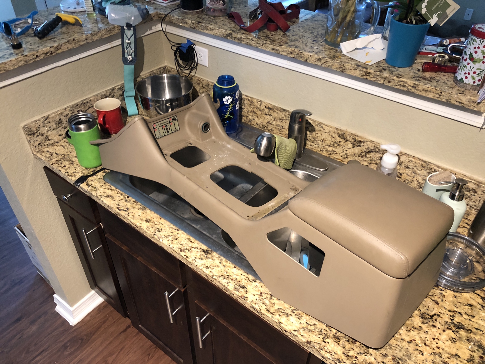

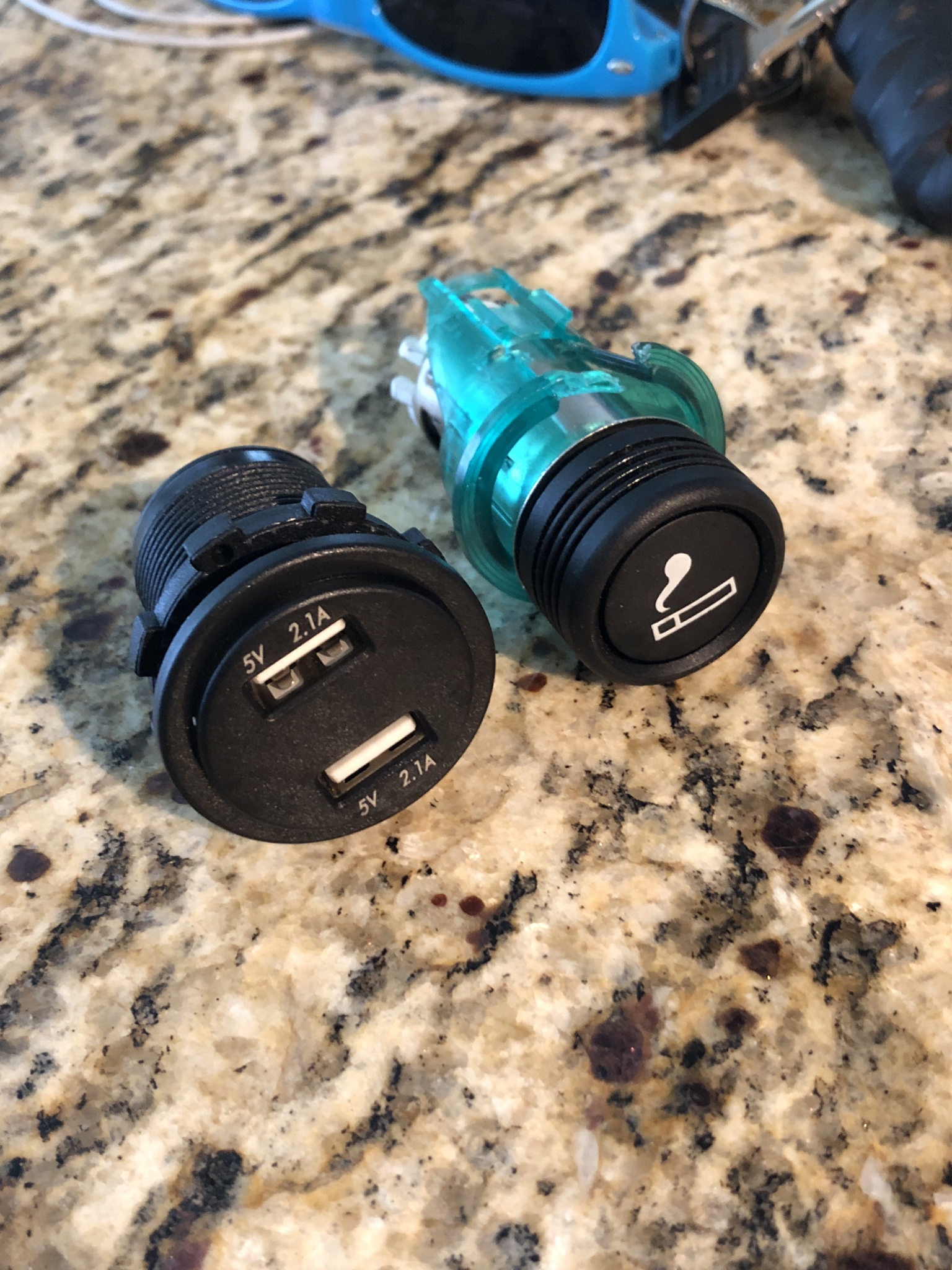

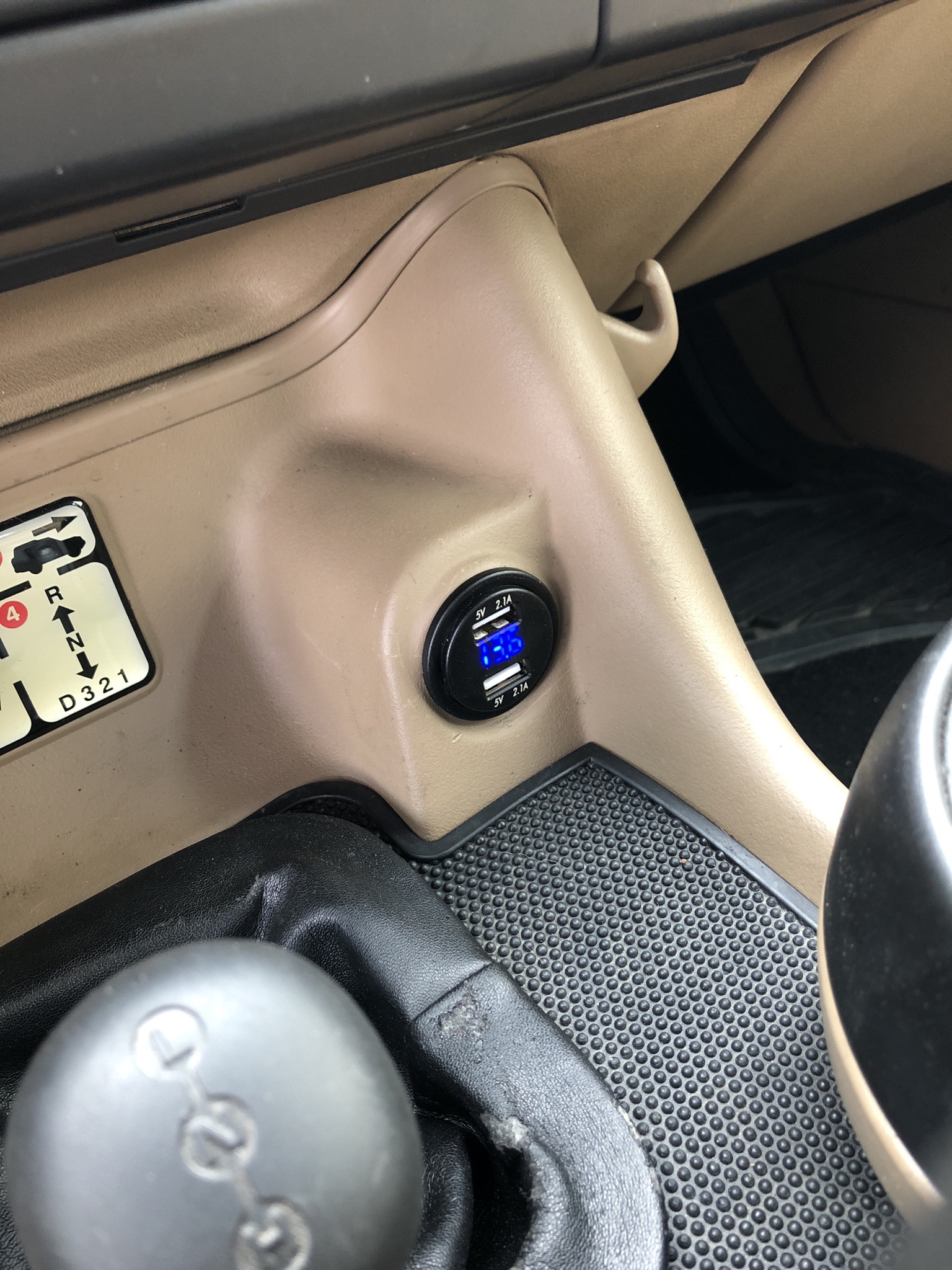

Been meaning to do this mod for a while now, did the same thing to my Wife's 93' Volvo and couldnt be happier. Super easy to do, just gotta tear into the center console and remove the lighter -- then wire up the USB port and thats about it. The cig lighter wires already had spade connectors on them, just had to remove them from the housing they were in and plug them into the back to the USB plug. Had to do a tiny bit of sanding around the opening to make the USB plug fit -- no biggie.
Gross.

Clean'er up

Old vs. New

Finis.

Is that a voltmeter as well?? Neat!
