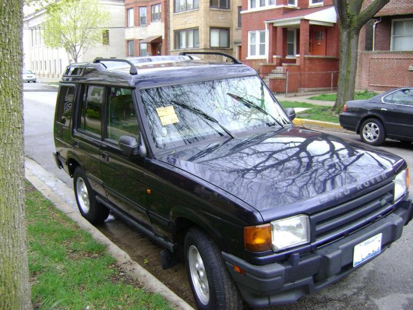

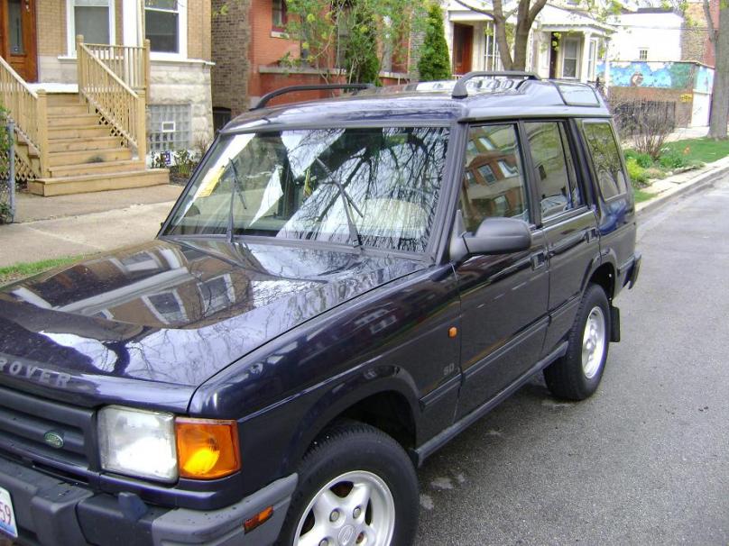

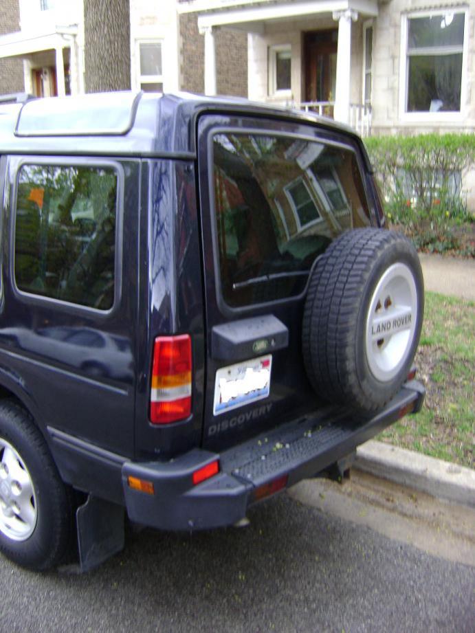

Ill inspect the brake lines and let you guys know if that works. Then maybe ill need more advise. I've put some pictures below. $850 doesn't seem like a ad deal. There are a bunch of problems but I think the cars worth $850 in parts. I hope I can get it up to speed.
