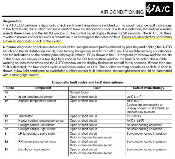

This won't help fix anything, but it might give you a clue as to what the Three Beeps were.
