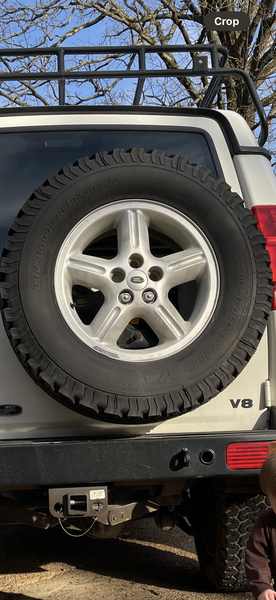

I mounted a 275/70-R18 (33”) on the stock carrier without flipping it and I have plenty of clearance. I moved the tire up and used only the top two bolts on the carrier. You can see the lower bolt sticking through the spokes. I have had it mounted like this for at least 10 years with ZERO issues. I recently had my bumpers, roof rack, roof rails and tire carrier powder coated and the tire carrier showed no signs of cracks or weakness.
Looks amazing and thank you for the info!
