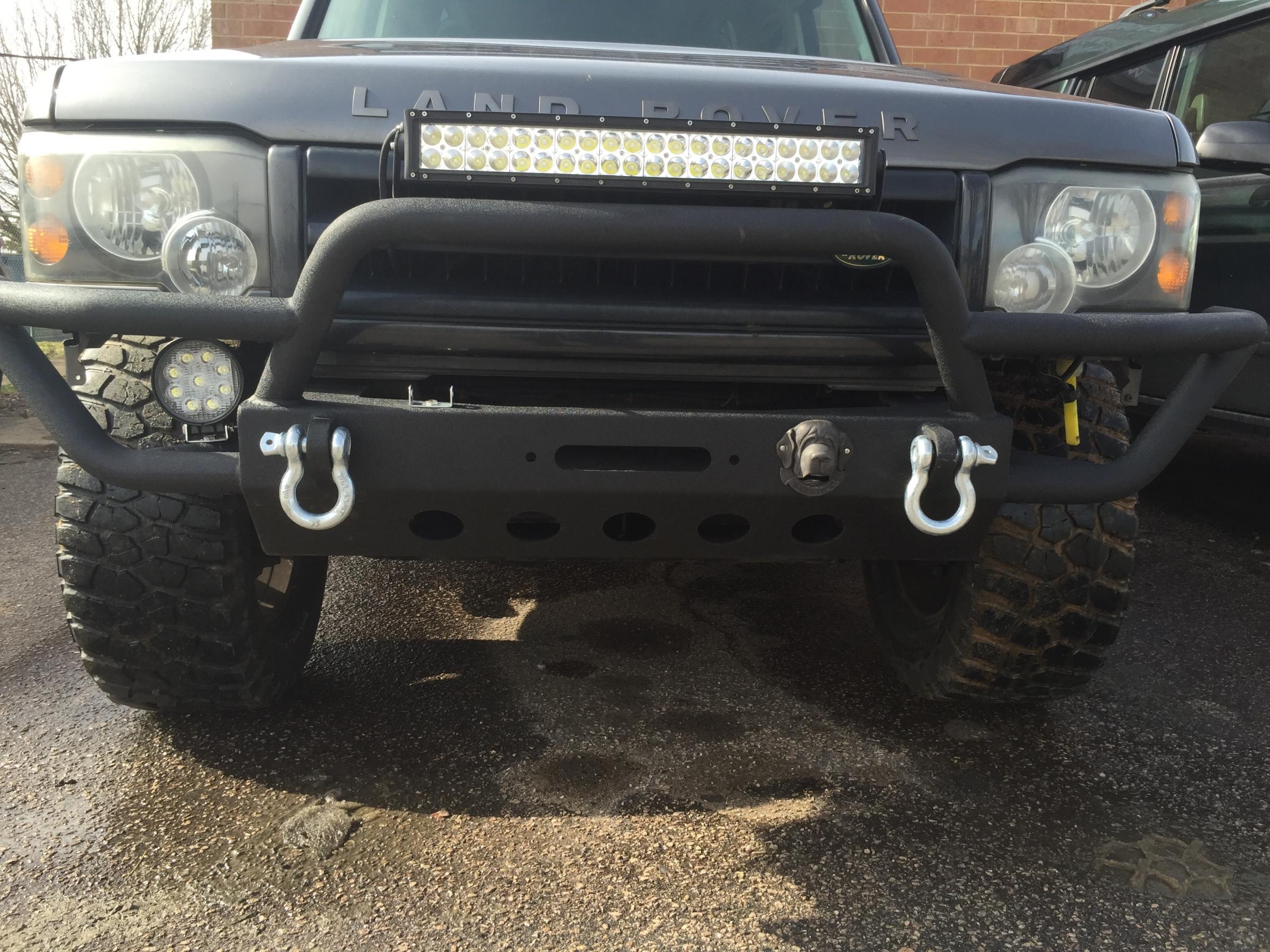

Any cutting or welding required to make that front bumper work or is it all just bolt on? That looks great and I hate aftermarket bumpers.

When you get the time, can we get a straight on shot of the front? I'm also curious as to what will need to be done/trimmed when a winch is installed. I really like the way the rear bumper looks too.

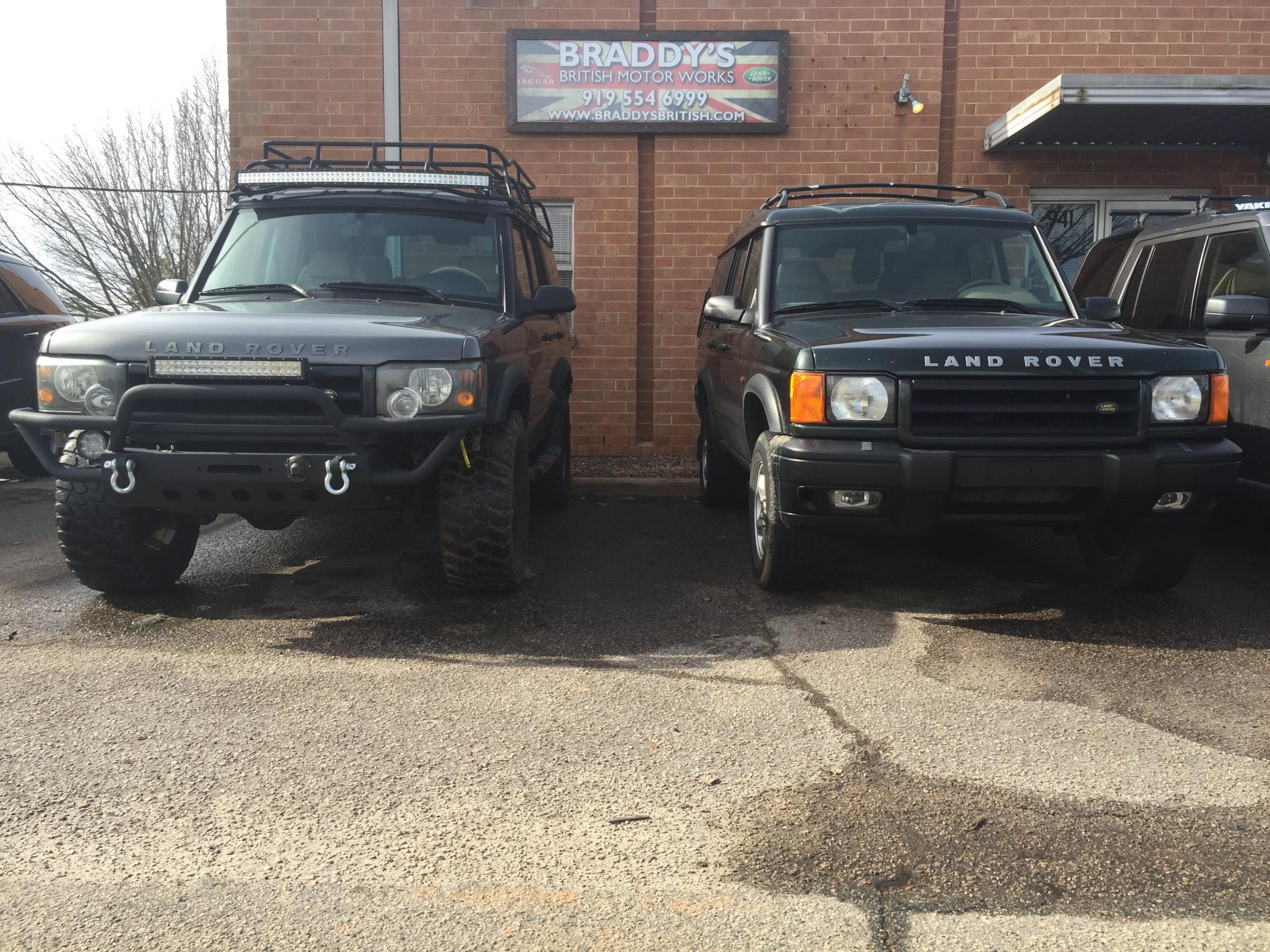

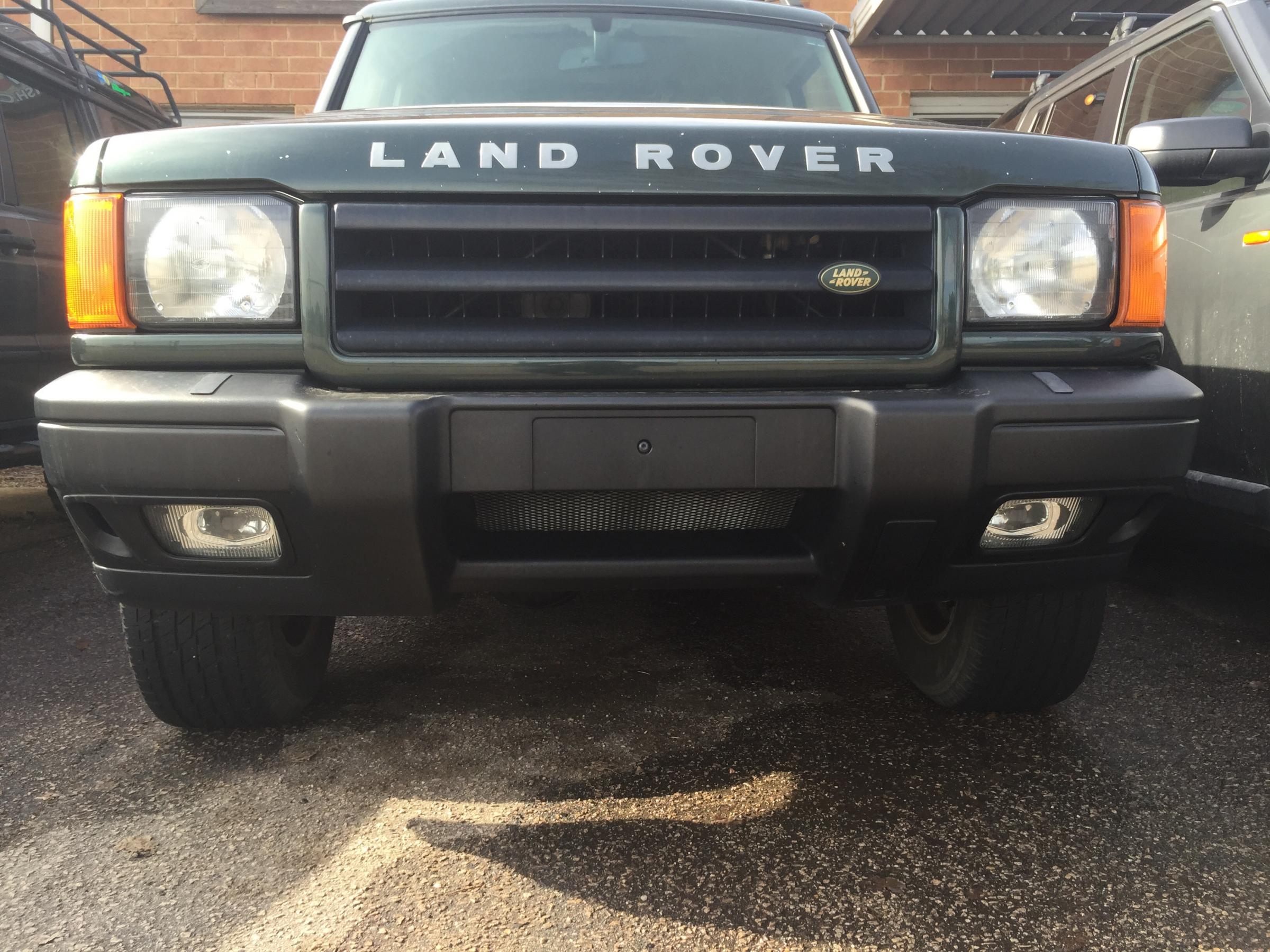

Here is one the Green one has yellow springs but stock tires, I'm not sure of how much lift. My truck has 2in spring spacers and 33's

The center of the middle on the very bottom is 19in to the ground. The round factory brace bar is 17in.

The green DII. Center on the bumper was 14 in and the round brace was 15.5 to the ground.

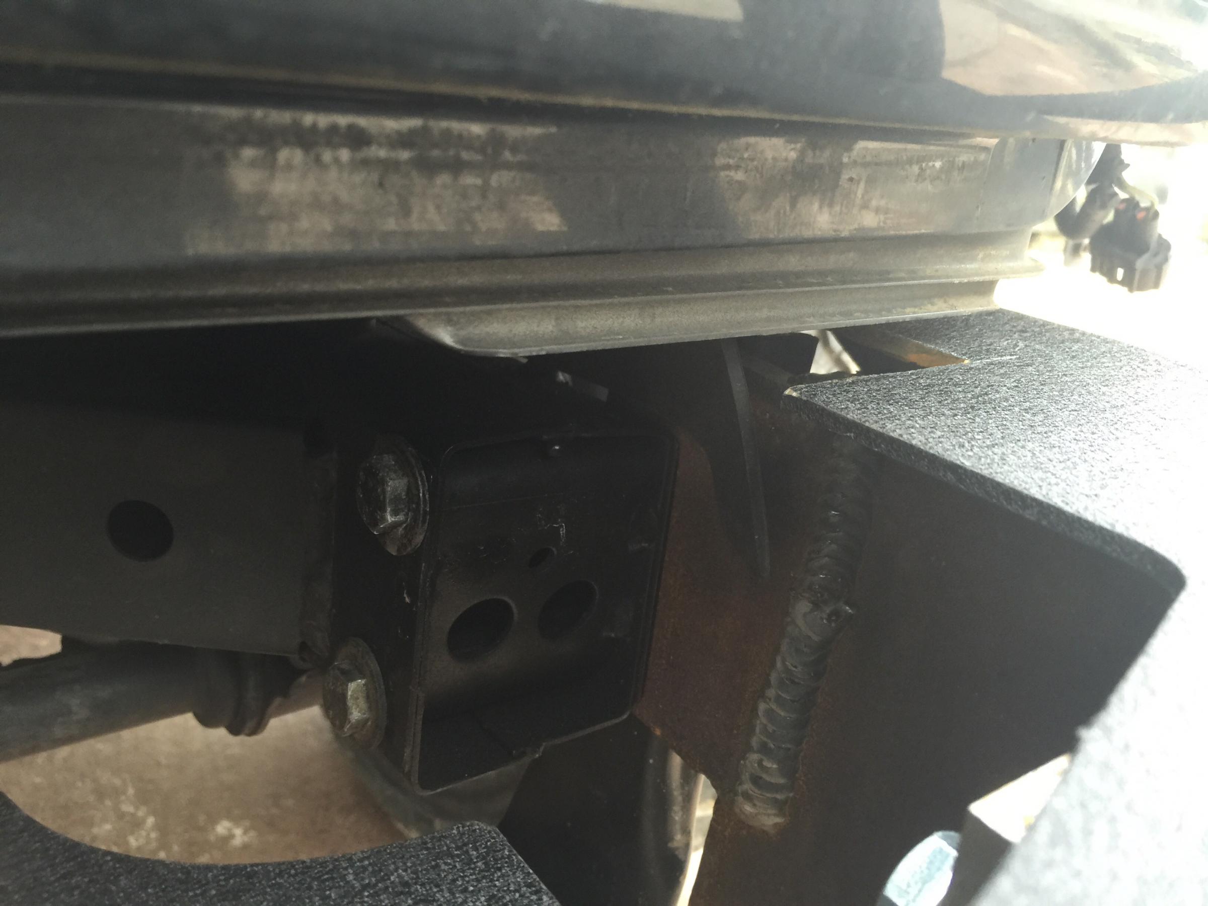

Here is a couple of pics of what I trimmed on the front bumper, but after some refitting, it didn't have to be trimmed. So in hind site if I did it again it wouldn't be cut. The front is just brackets.
