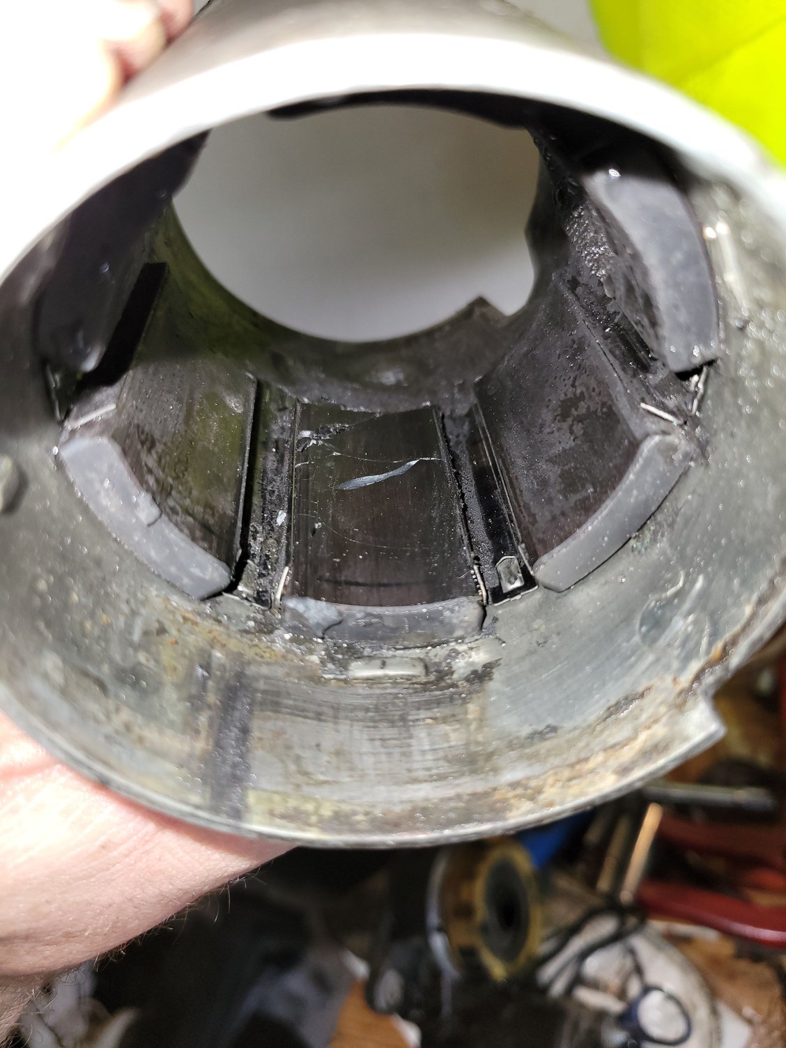

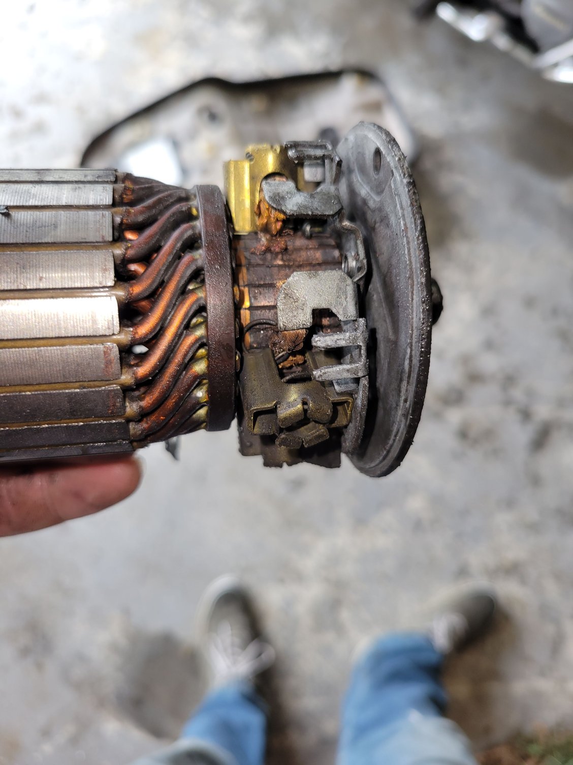

just going to assume that it needs replaced
tried hitting it with a hammer with a short crank of less than a sec
Cleaned all the connections with no luck
It cranked very slowly for about a sec then that's when it stopped cranking
Battery is new, tested it aswell so it's good

Looks like you are all out of brush, they do wear out eventually.
