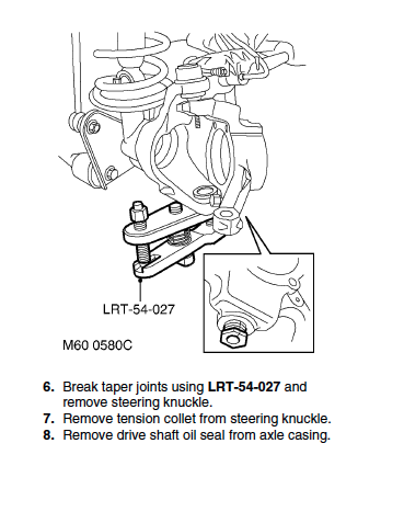

Has anyone had trouble getting the steering knuckle to come loose from the ball joints? From what Im seeing it looks like the Tension Collet is keeping it on. Ive tried everything that I can to get it to come off/loose, but it wont move.
Ill attach a picture from Rave.
Its the expanded section at the bottom of the knuckle.
