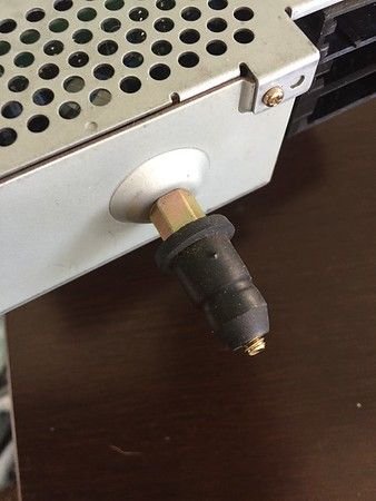

Steve, I've removed a couple of these now and have thought about why they are hard to remove.
I have one out if you need more pics btw.
One you put the file folder hanger in the slots, the only thing holding the radio in is the rear bumper.
I believe this fits into a hole back in the dash.
I used flat plastic interior trim removal tools to gently pry the radio out. Much like a plastic putty knife or spatula.
I also stick my finger in the tape slot and pull from there. It will come out! Keep working it.

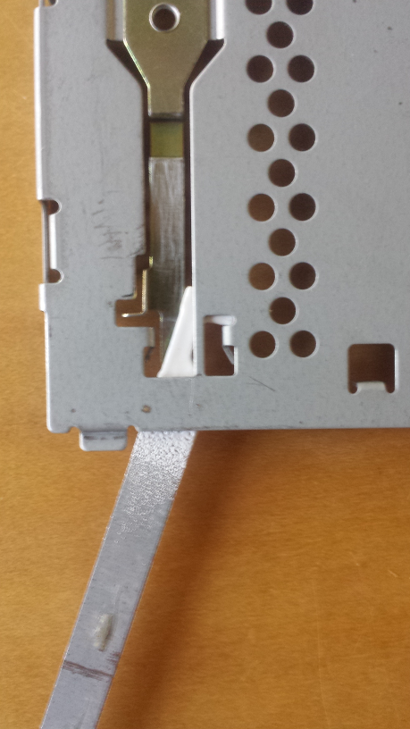

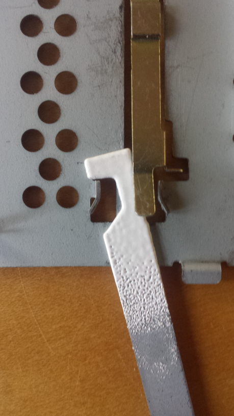

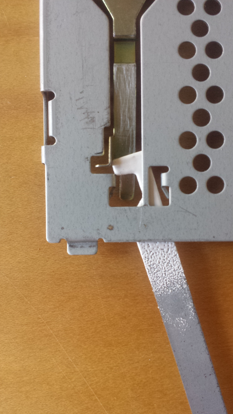

Here is how it goes. Also, I removed the rubber boot. The stereo sits tight enough without it, but it is easier to get in and out.
Push them in to depress the spring with the gaps inwards!
Move the hangers outwards.
View from underneath.
Using the gap outwards doesn't work , since the spring is in the way.
