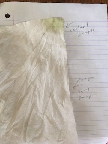

I was able to get a cleaner sample of the liquid and compare it to the coolant. I don't think its coolant, it appears to be clear and odorless. The brown color must have come from the carpet.

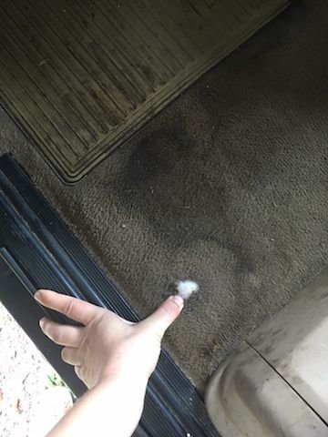

Here's a photo of the liquid bubbling up when I press down on the carpet. This is after vacuuming the area for 30 minutes and then driving 1 mile. Its surprising how fast if came back.
Maybe time to check the sunroof drains? Whatever is happening the liquid is either being stored somewhere or regenerating at an alarming rate.
