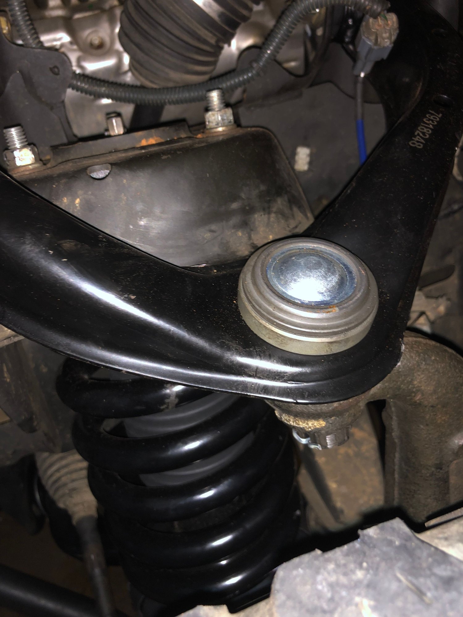

Once I got it all together, i put the jack under the LCA and jacked up a bit. I would have thought I would see the spring compress a bit and some articulation. the whole truck lifted off the jack stands.
Is that normal? Shouldn't i have some articulation? That's the whole point of having suspension. The UCA is actually touching the Top strut mount and when I jack the LCA up, the coil doesn't even compress enough to move the UCA any.

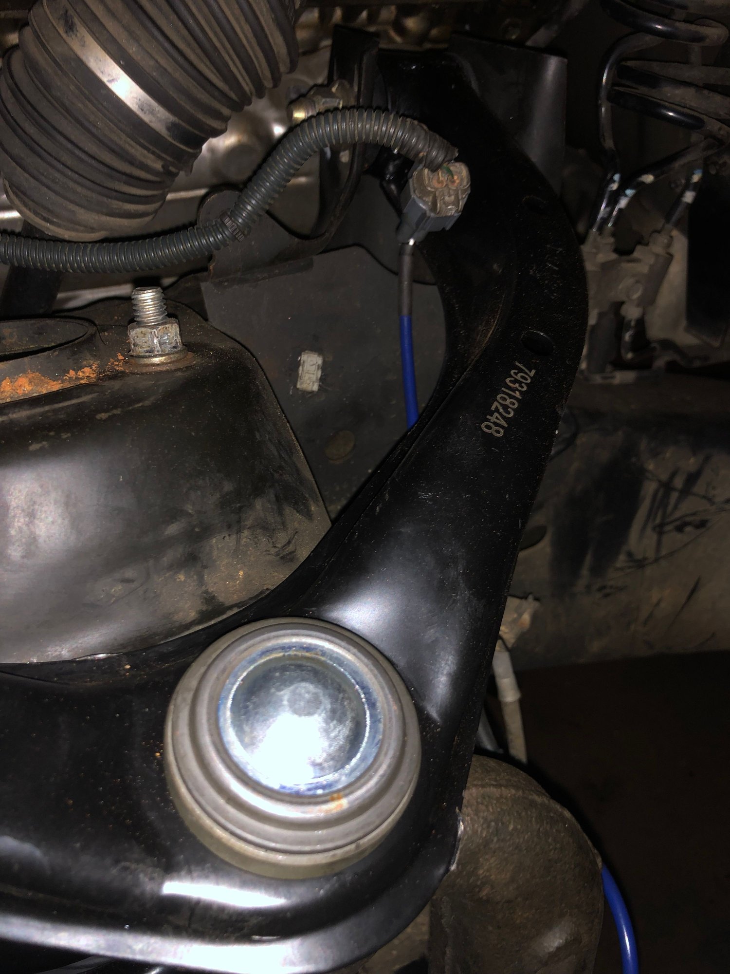

Well, got everything together and when I dropped her on the wheels, the suspension did not budge a bit. I have not torqued the UCAs and LCAs as you are supposed to do this under after the suspension is under load.
As you can see, the UCA is hitting the strut mount.

I went for broke and jacked the truck up really high and just dropped it.
I didn't hear anything bang and it bounced pretty well.
Rechecked the clearance of the UCA and now there is about a 1/4 inch gap between the UCA and the strut mount.
I think I am going to bounce it a few more times then torque it down.
Maybe that stiff spring just needs to settle in.
