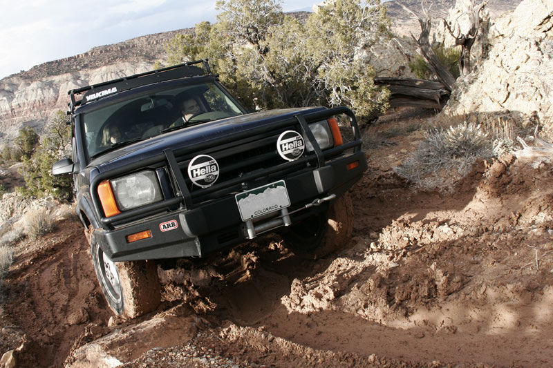

Here she is with her old worn out suspension and stock sized tires..

Cant help with suspension, thats just YOUR choice, everyone has diff opinions / ideas.....
But I cant help noticing the Bumperettes on your ARB are on the wrong sides / upside down..the slope should be at the bottom.......
Like this,

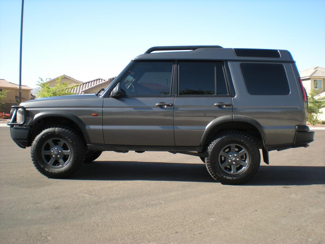

did the OEM 2 inch this weekend and chucked on some 265/65/16 Duratracks.
i went from this..
to this...
Give Justin a call at Lucky8, he was a really helpfull both pre and post sale. They are a quality outfit and good to deal with...
I think it turned out pretty good..
Dave
