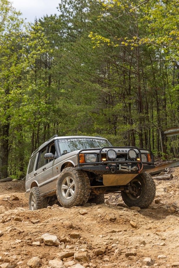

I know it's not a massive difference, but if I can get the parts cheap, then why not? Being on 35s and armored up, it's just so slow. Obviously, it would still be slow with a 4.6, but if it makes merging on the highway easier, then it could be worth it. I'll try and see if I can find someone with a 4.6 to drive and compare how it feels to my stock 4.0, that's a good idea.

Thank you for all the info! I already had a set of long tube headers I got a good deal on I plan on using, and have no cats and an aftermarket resonator on it right now. Also my truck already has an oil cooler stock thankfully. The 5 speed d1s definitely felt faster, my dad had one at the same time as an auto and even with a higher mile motor, the 5 speed felt quicker for sure. And yeah I don't expect it to feel like a rocket ship with 4.6 internals, but anything extra could help. Mine scaled at a hair shy of 6k lbs, so it could use the extra power.

I'm on 17" BMW alloys and 35" MTs, but that won't be changing at all. I have a Honda I daily drive and a second d2 that's only on 31" ATs for light duty stuff, this truck is only for the hardcore stuff. But I don't have a truck and trailer, so I have to drive it to each park, most of which involve driving through the Appalachian mountains, so a power bump would be nice.
