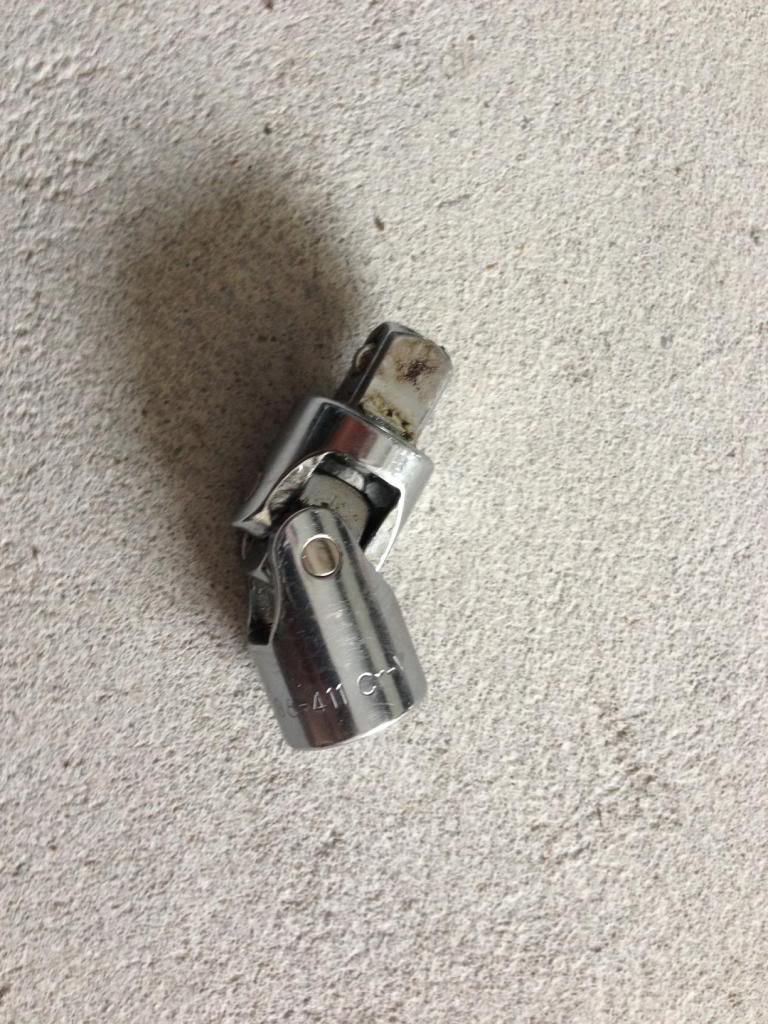

I just did this last week, diffs, tcase, and trans. First, I couldn't move the e-brake cable out of the way, at all, but my universal 1/2 socket worked with ease to get the fill plug in/out:

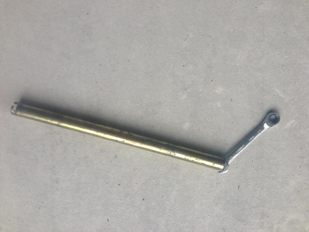

Next, about the top bolts, I used the same 10mm ratchet but add some leverage. My favorite tool for doing this is to use the extension bar thats in the pack with your land rovers tire iron. I'm doing the drive shaft now and I'm even using that to add leverage to my socket wrench, but here's the 10mm with it attached.

Try it! It works great and will give you the leverage you need to get those last two bolts out. I went to ace hardware and bought all new replacement bolts as well. Looks great all cleaned up with shinny new bolts. I also filled it up with 85w140 and she's nice and smooth now, and no leaks!

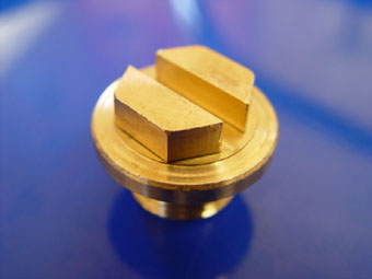

First, make sure you are using an 85/140 gear oil to slow down your wear, where exactly is your leak coming form? I used some White Shepherd oil stop leak a couple of yours ago for one dif and my t/case, neither have leaked since.
As for a good brass plug, go to British Parts of Utah, they have a great brass plug.

i got brass plugs for the front and rear diffs at rovahfarm.com, they had nice prices as i recall.

Thanks for the heads up on the brass fill plugs. I'll look into those.

Thanks Andrew for the pictures and encouragement. I think I will take another stab at in a few weeks. I'll try some of the methods you suggested and hopefully I can get them off!
