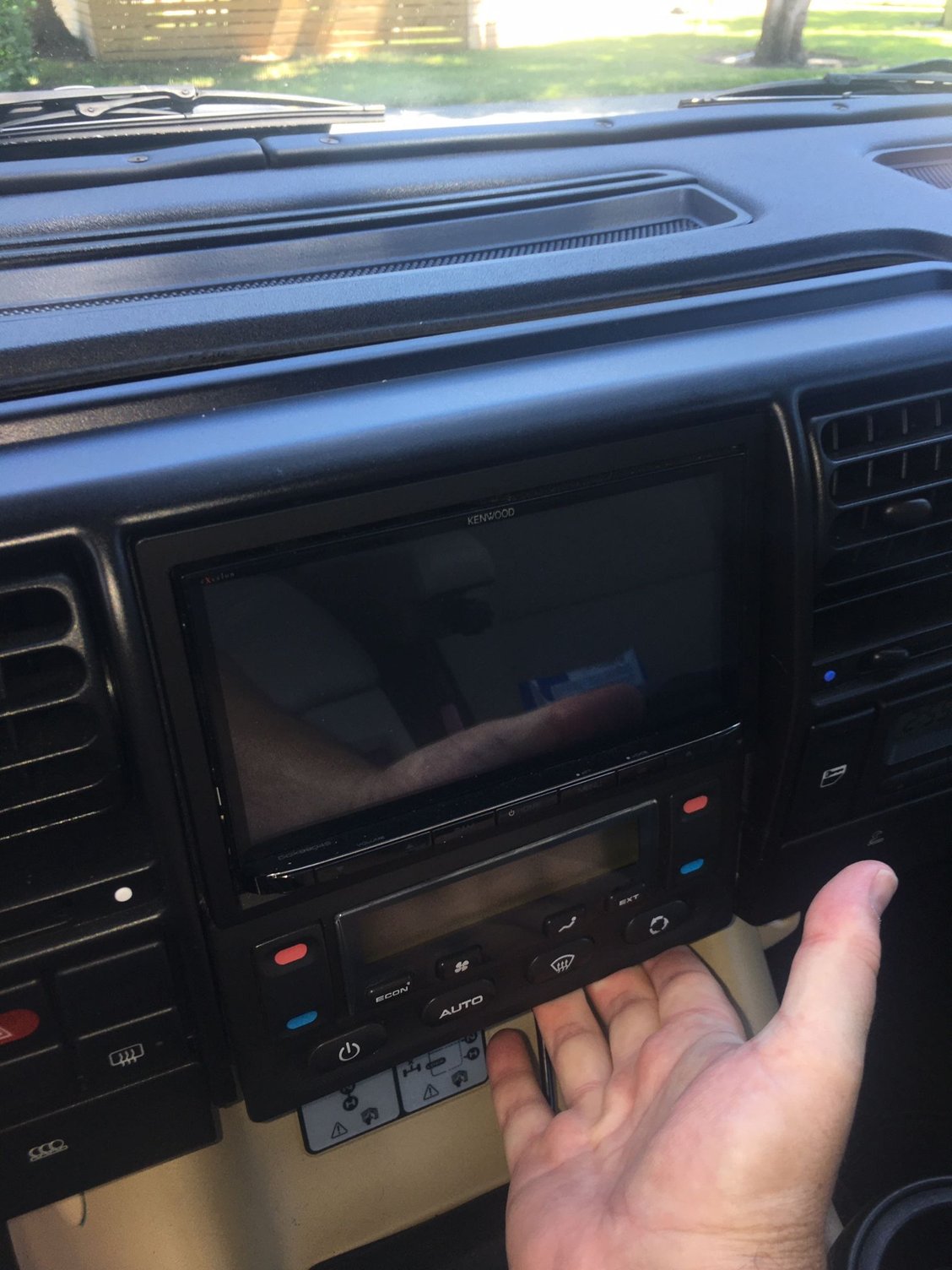

I upgraded to a Kenwood 7” or so touch screen head unit. Satellite, apple car play etc. Nice having something that new cars come with. Maybe better than some new cars.

The sat antenna is flat circle approximately 1.5”. 1/4“ in height. Truthfully I use the SiriusXM phone app connecting in with cable for apple play majority of the time as well as the gps maps on phone that are displayed on the head unit. These days it’s wireless and no need for cable but I like that it charges at the same time. Hope that answers your questions.

Sounds like Sean has THE system! Sean can you let us know what gear you used. Did you need mods to doors, rear subs etc
i have a Kenwood DDX9904S. Several years old at this point but I liked that it had no ***** etc...clean looking.
Holding the gear up with my hand due to replacing the climate control and upsetting the glue holding everything in properly. Next on my to do list.
