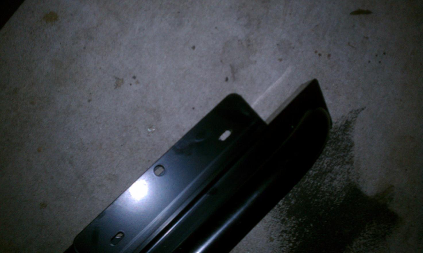

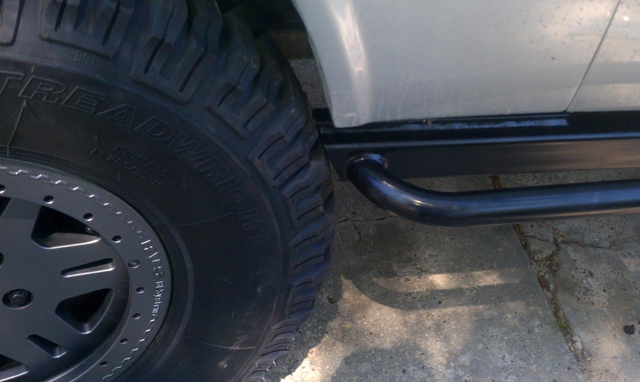

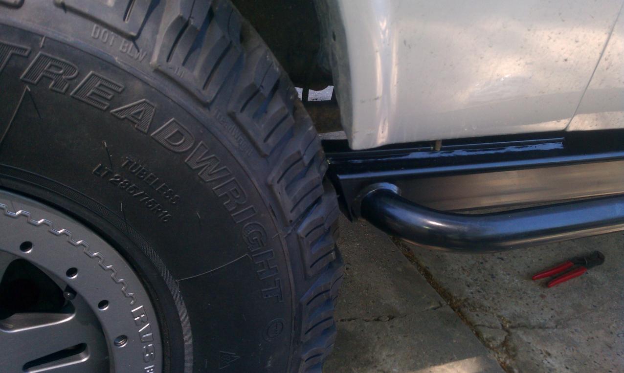

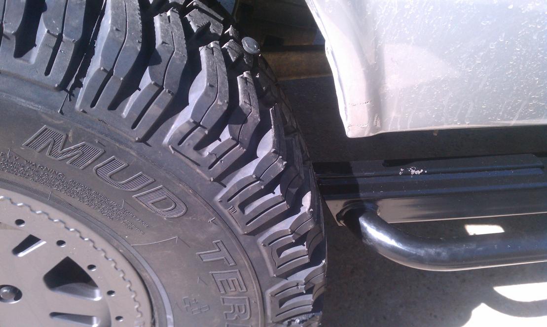

So it turns out than the sliders are a little long. I can cut them in the front but I can also trim them where they mount up at the corners where the hit the lower door sill. Anyone else have this problem? Not one hole lines up. I expected this. I swear I buy more things to better the truck than its worth. Loving a Rover is not cheap!

Can you shoot a photo of what the rear wheel well looks like when they're up like that?
