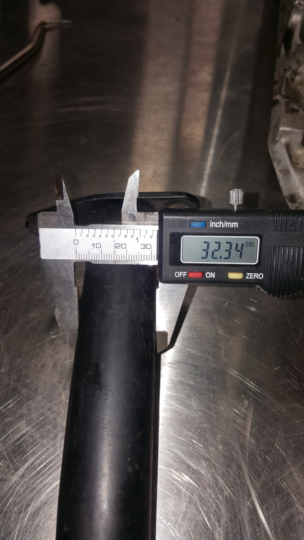

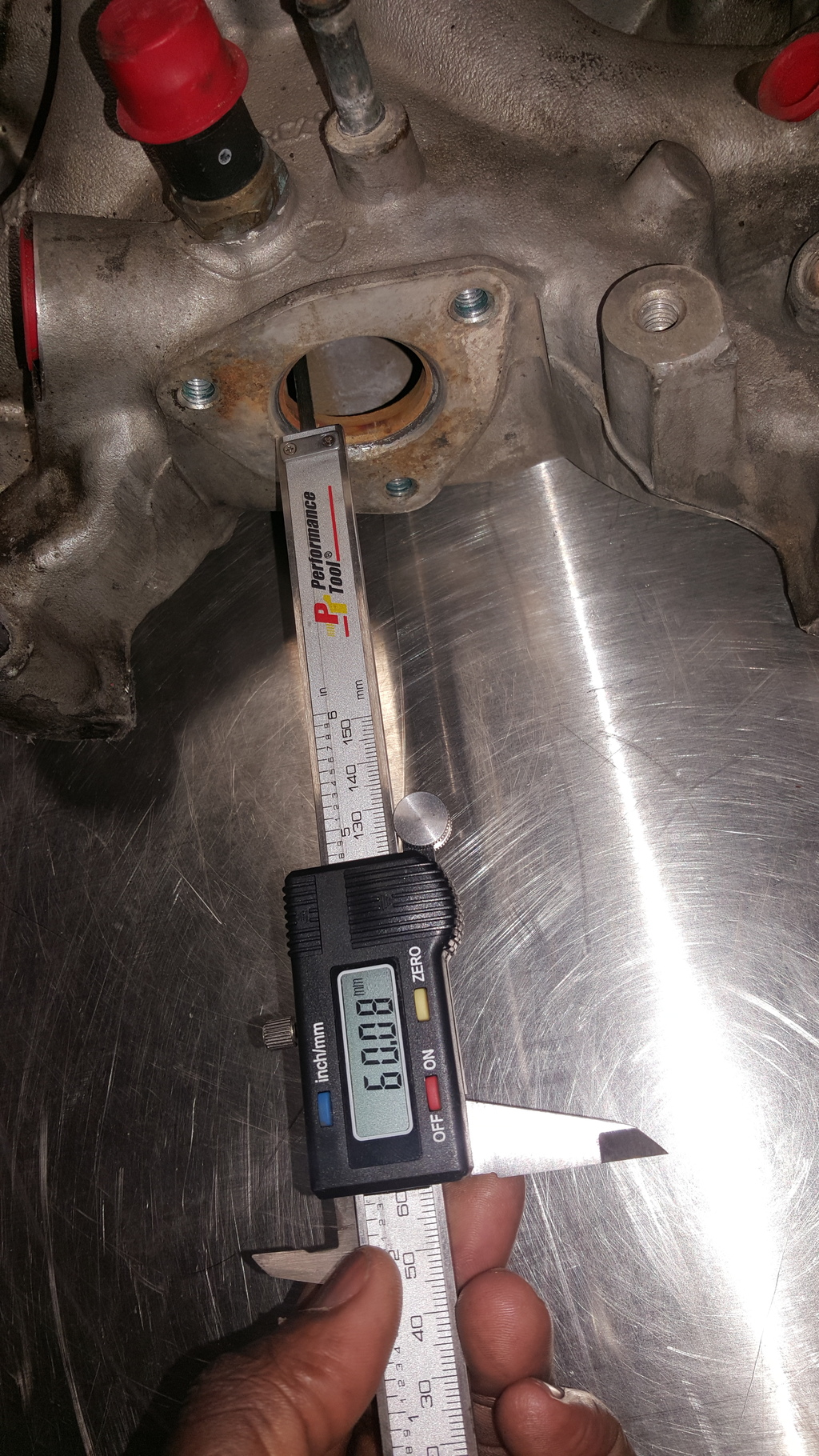

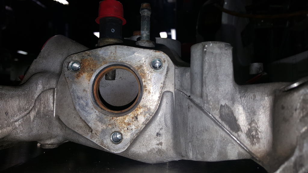

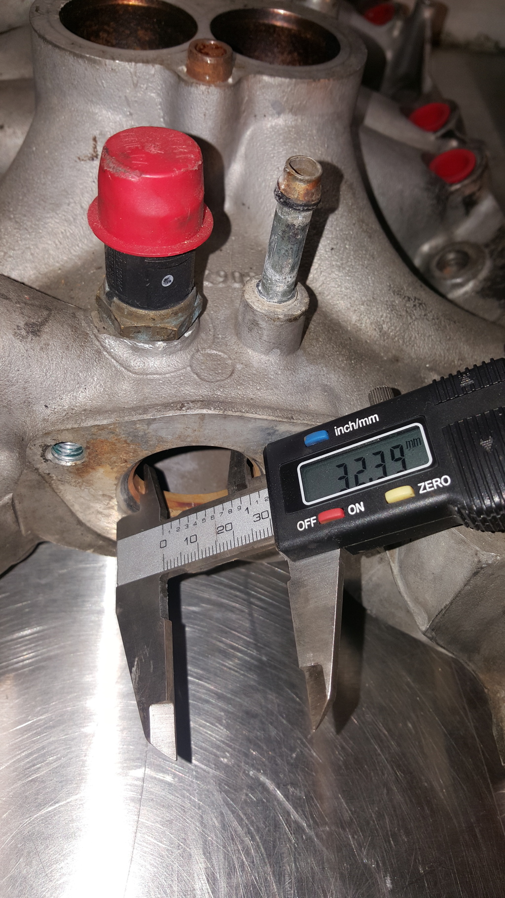

Pictures with some measurement.
Note the position of the temp sensor. This will make diagnosing bum thermostat a million times easier.
Also, didn't take a picture of it, but the measurement of the water neck on the side of the manifold is 29.38mm (give or take a couple tenths for rust and the bevel gets smaller)
Now to find a thermostat.
Anyone got a chevy thermo laying around they can measure up?

if it dry out this weekend ill go to the bone yard and pull a lower intake, and drop it at my machine shop to have it fly cut to accept a GM type t-stat.
then it just a matter of finding a usable t stat out let, the intake looks to have plenty of room to drill and tap for a different bolt pattern.
a steel one would be nice you could cut off the stock neck and reweild the tube back on.
Old Mar 17, 2016 | 07:57 AM
dgi 07's Avatar
Posts: 1,570
Likes: 99
Feasible, but the manifold already has cast areas for the bolts. If you stick your finger in there, you feel it.
Not to mention the lack of space that's there. One side (alternator) you have all the room in the world, compressor side has no room to work with.
That being said, lets see what your machinist comes up with. I'm trying to find one now.
