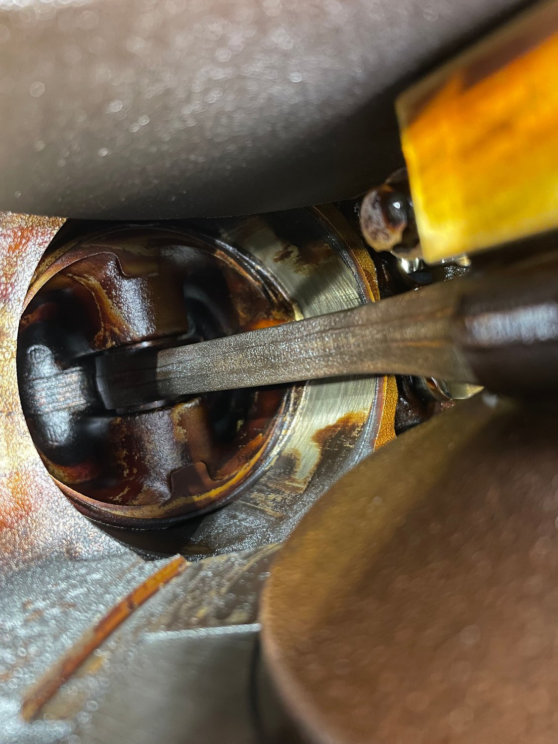

Thoughts on a few photos of underside of the pistons?

Snapped a few photos while I had the oil pan off. Everything look OK for an engine with 190k?

Pistons look normal to me for the milage. Not sure about that oil residue on the cylinder wall. Someone who knows more than me will have a opinion.

Normal

Cool cool. Pretty sure PO did semi-regular oil changes since in all my adventures with this engine, I've never found sludge, but I do think they were using a Dino oil since ...I think? ...synthetics don't stain the aluminum like this? IDK?

The varnish is a by product of the crappy factory PCV system. Likely half its life was run with that vent plugged up.
