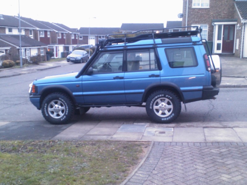

I went with 245/75 16 Bridgstone Revos, great in the snow and off road
