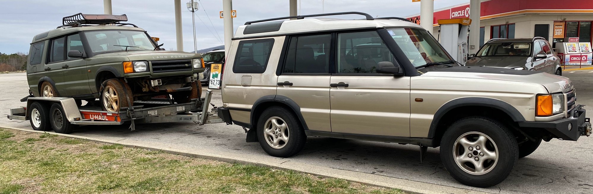

I have towed Discos (4400 lbs) with a Disco using Uhaul trailers (2200 lbs) max distance so far 5 hrs. Gets a little squirrely over 65 mph, but otherwise fine. Rear air suspension or rear coil helper airbags would help because the tongue weight raises the front end and reduces the camber on the axle.
