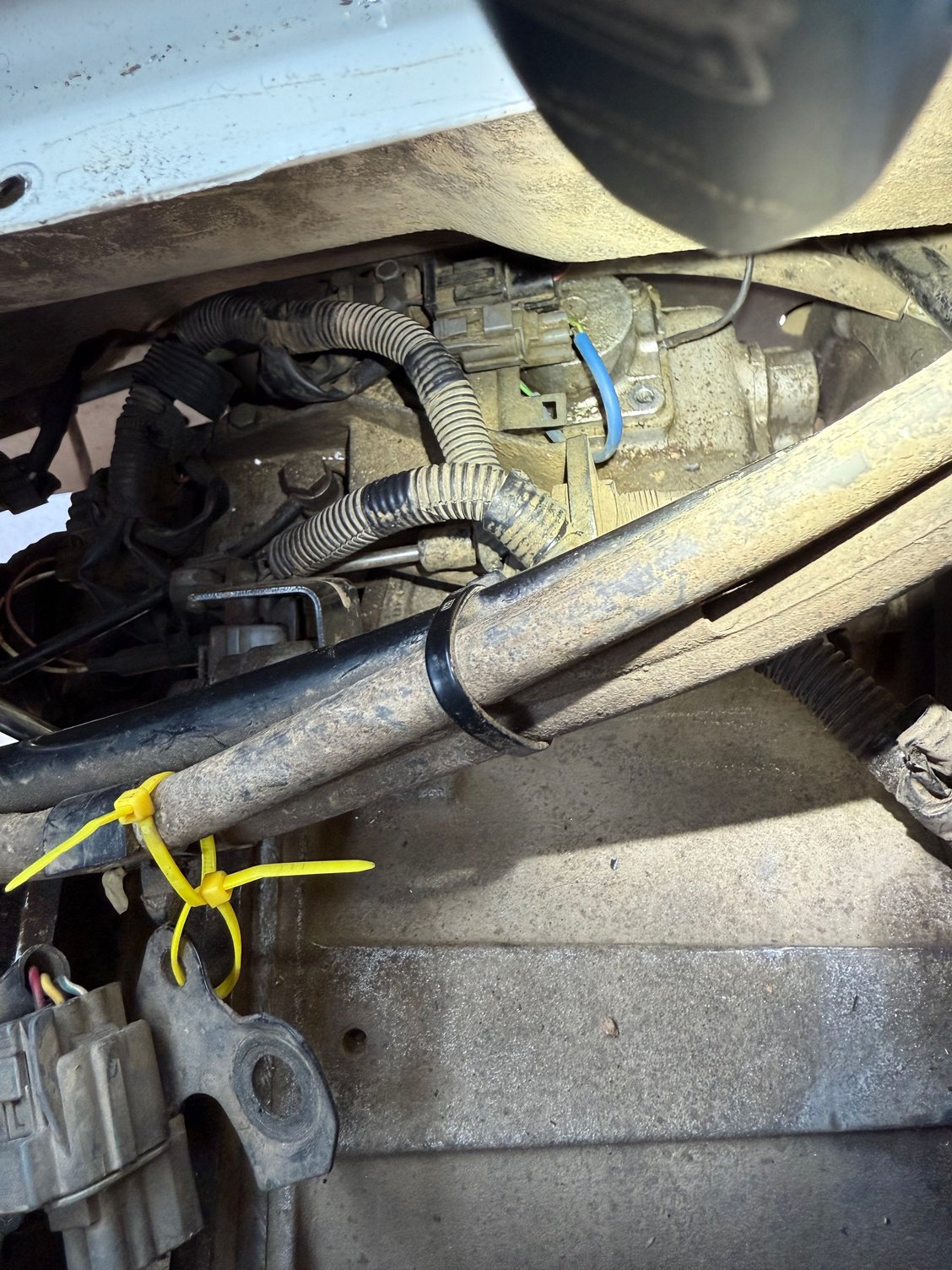

Hello. Currently i have removed the center console and inspection cover. I have found the solenoid. I am have issues getting to the 3 of 4 8mm bolts. Does anyone have any tips on removing this solenoid. Do i need to remove every thing above it.
Old Feb 1, 2026 | 11:54 PM
  #28
Harvlr's Avatar
Joined: Sep 2020
Posts: 2,960
Likes: 755
From: British Columbia Canada
I only did this a few months ago but I don't remember for sure. I think I did remove it al but it wasn't as big a deal as I thought it might be.
