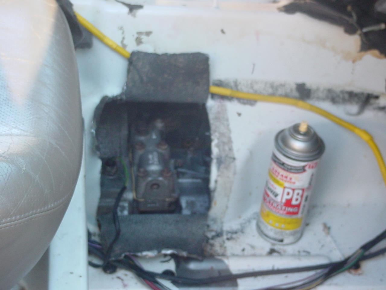

I have a 97 DI 110k. I have had it for three years now. When I first got it, the transfer case shifter would not move. I removed the console, took it all apart, greased everything real good, replaced all the little linkage clips, lubed it up real good.

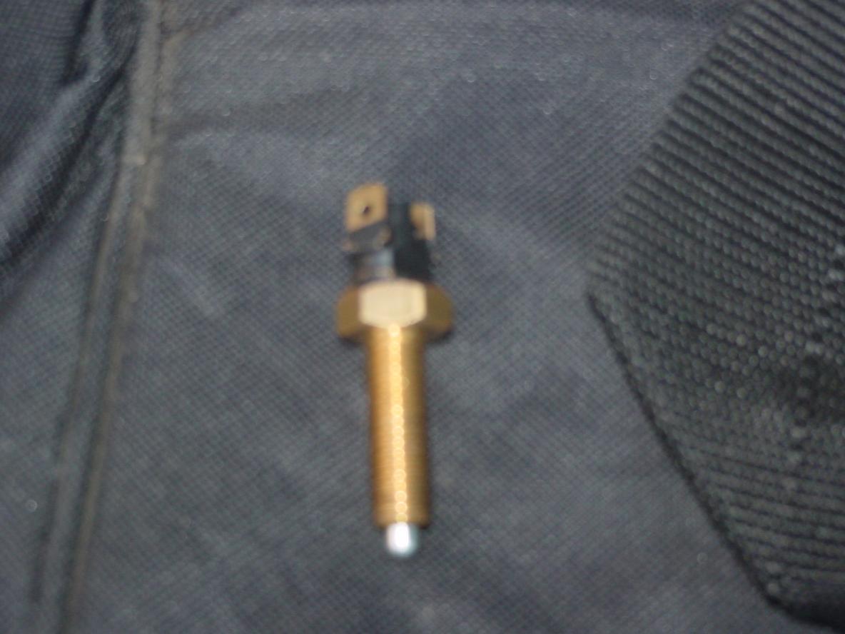

It shifts from hi to low no problem. It moves side to side, but never locks the diff lock. No lights on dash. I got a new switch (the one beside the solenoid cover). The old switch reads open circuit no matter which position the shifter is in (right or left).
I even cut a hole in the floorpan to gan access to the switch. The nut on the old switch is bigger than the nut on the new one and I cannot get the connector off or get the nut to budge to unbolt the old switch. What Gives? See Pics: All help appreciated.

If you look at the pics I posted, you can see one side of the solenoid cover and two boltheads beside the switch I am having trouble with. I opted to make the cutout rather than unbolt the transmission shifter to access the switch and solenoid area.
I saw it was wide open on inside of the tunnel sidewall, so I drilled four holes that i thought were far enough apart to get my hand in, cut with aviation snips, then enlarged the opening by continuing the cuts at the corners and peeling the top and bottom further open. I can see and reach the switch, but cannot get the darn nut to budge or even get the connector off the top. I have the replacement switch, but have a concern regarding the difference in size beteen the two nuts. If I pull the solenoid will that do any good? The switch reads open circuit regardless of tc shifter position. I know there is a ball device in the end of the switch, what does it take to activate this in the mounted position?
