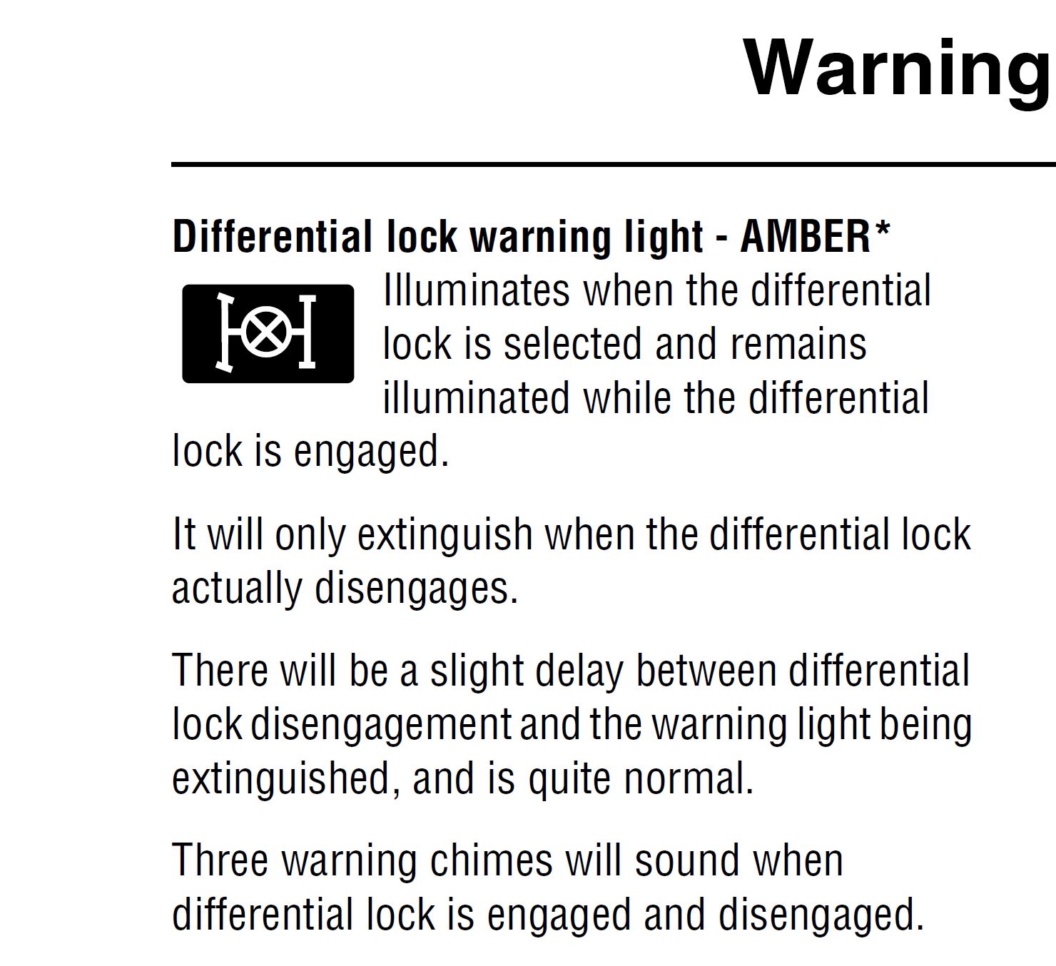

as a member who has an 03 and put an 04 t-box in there dont forget the transmission harness, with this the t-box lock light will illuminate on the dash when locked.

Please tell me more. I just had an 04 transfer case and shifter installed in my 02 and do not have an operational CDL light. I worked a deal and had a Rover shop do the install and have not had a chance to dig into what they have or have not done yet but have heard mention of adding a ground and jumper from a connector near the selector to the switch on the case. I have added the 03 000150 SLABS unit.

alpinacsi, there is a light on the instrument cluster that will light up when the dif lock in the transferbox in locked, if you install the 2004 transmission wiring harness the light on the dash will come on when the dif is locked.
jimmyk, you will need to start a new forum thread but yes there is a large solenoid on top of the t-box
