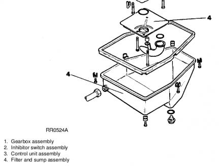

Never seen a Discovery I sump, but the shop manuals for I and II pictures attached could suggest that the Disco I dipstick tube could be fitted instead of the Disco II plug
Attached Thumbnails Transmission dipstick/filler tube-disco1-zf4hp22-sump.jpg   Transmission dipstick/filler tube-disco2-zf4hp22-24-sump-.jpg

DI and DII oil pans are the same with. If you want a pan and dipstick I have one left in stock. PM me and I'll give you details.
Cheers,
Paul
