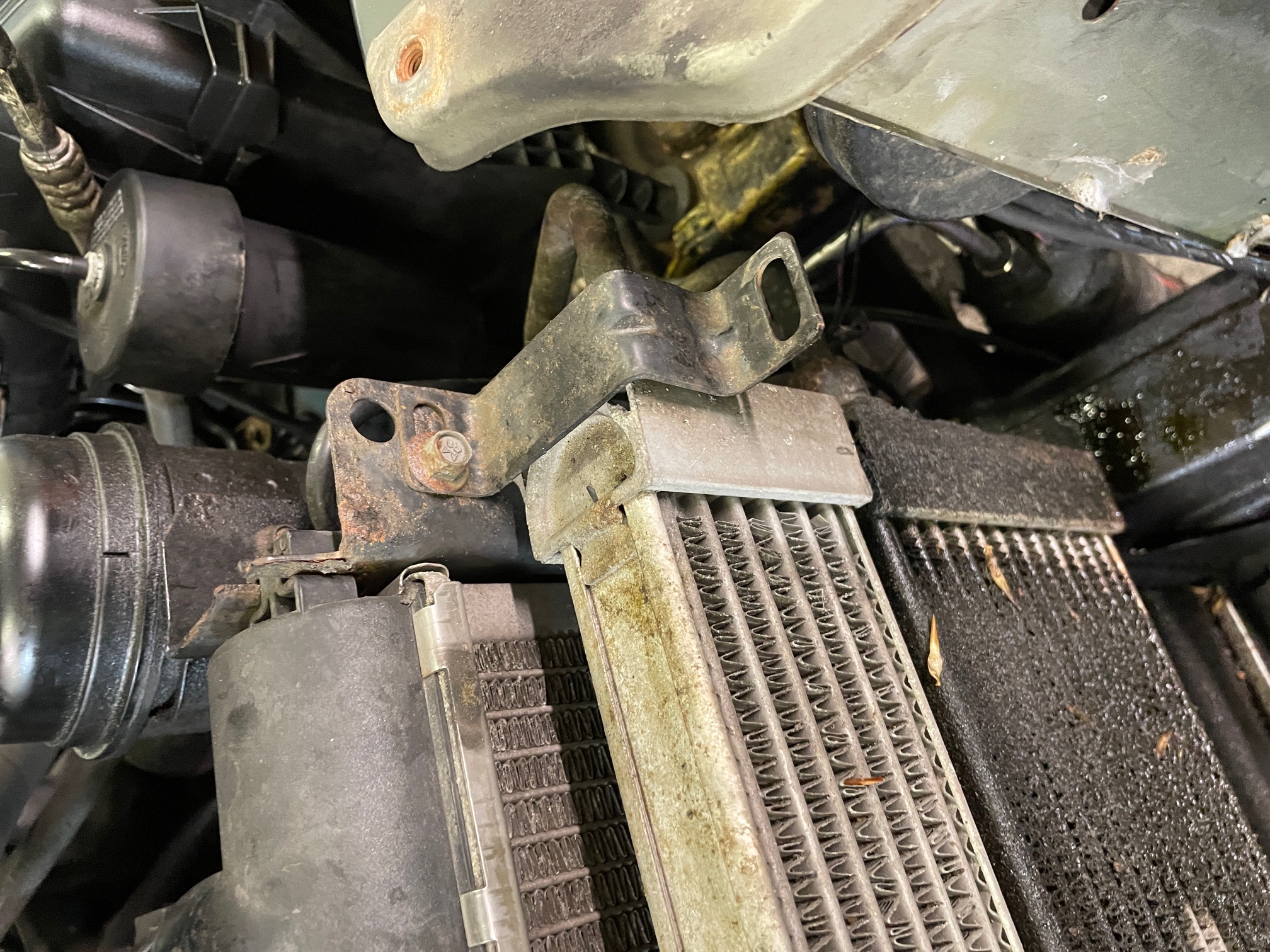

Realize that air flow goes through the A/C condenser, then oil and trans coolers, then the engine radiator.
Something as simple as an A/C leak can clog your radiators. Here is a pick of the radiators on my P38 when I first bought it. I installed new.

yes. the black sludge in/on the cooler in my picture is exactly that. a small refrigerant leak blocked a major portion of the cooling area. The A/C condenser is removed in my picture.
If you loosen the bolts to the mounting brackets you might be able to determine if they are clogged without dismantling the A/C system and need to recharge it.
