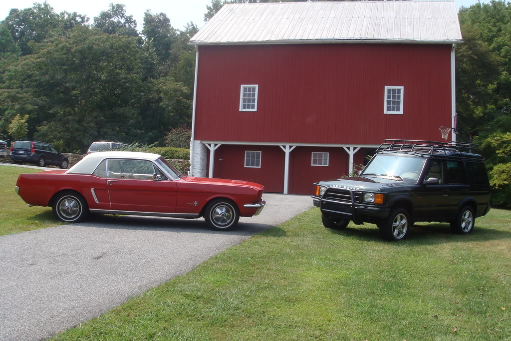

yea i did this ^ to mine, turned out greatName:  DSC00732.jpg
sorry this is the only pic i have now that i'm studying abroad.
