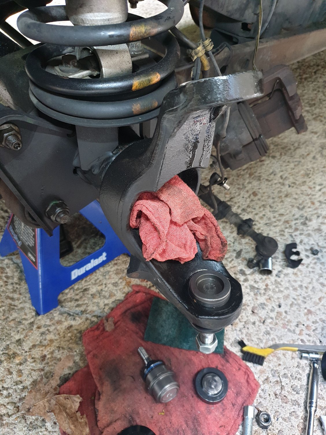

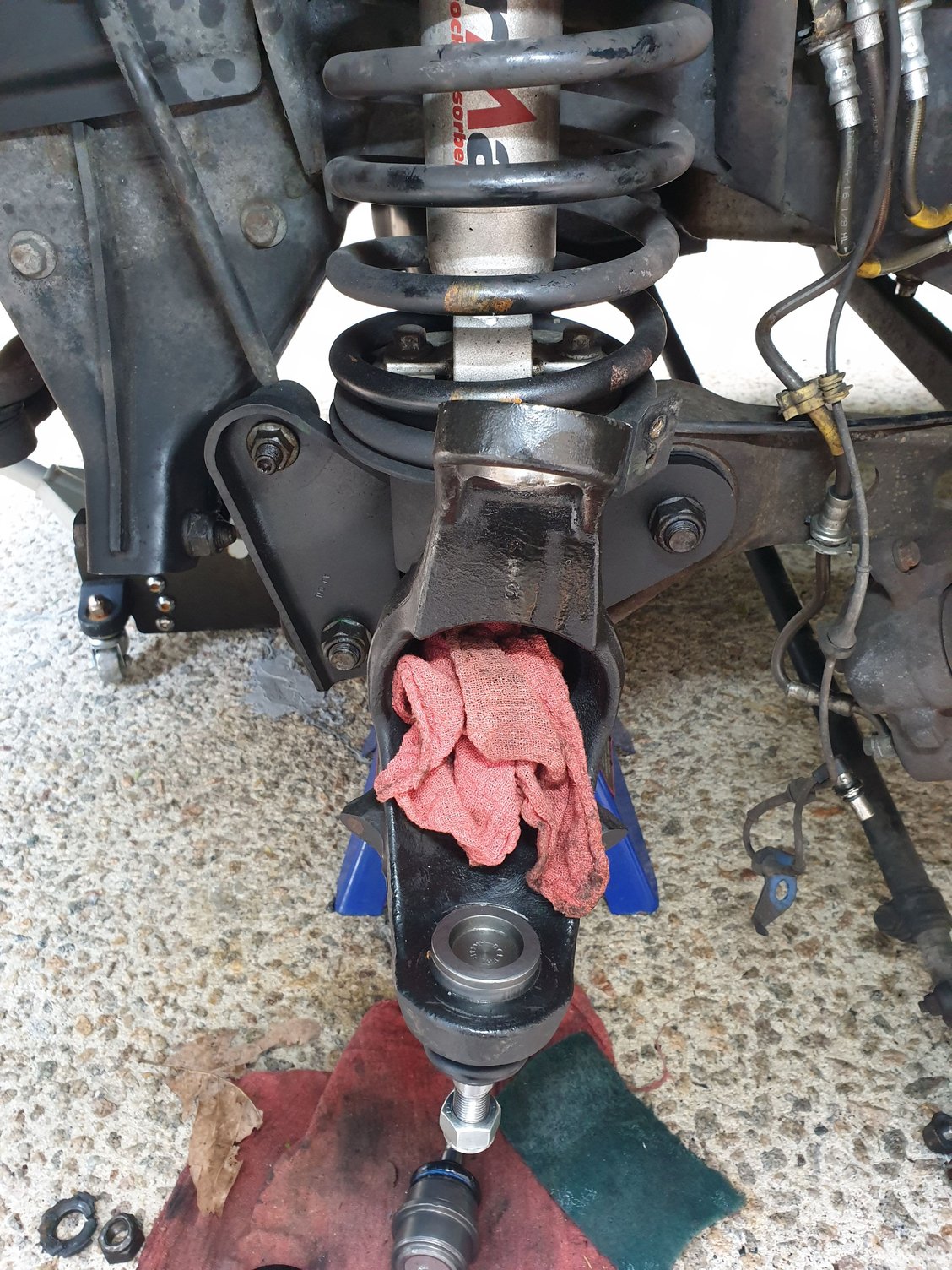

So, got the parts, and a new ball joint press kit... Watched all the videos online that I could find, and read a few post from here.

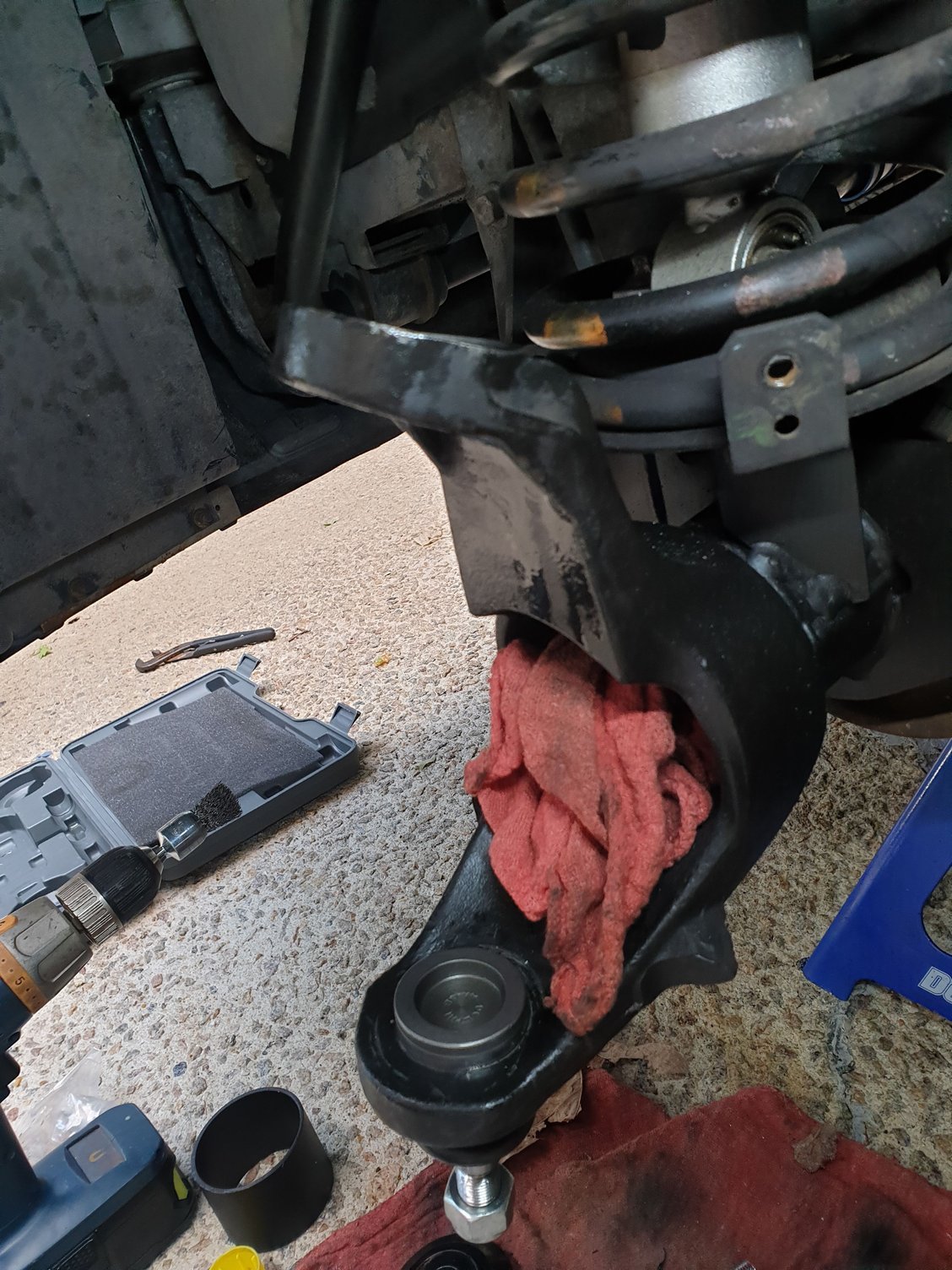

It was a lot harder than I thought it would be to get the old ones out. Cranked pretty hard to get the lower out especially.
New lower went in fine once I had it started, but the upper just won't start.
Is it possible that I bent the hole of the upper getting the lower pushed out?
It looks a bit wonky, and the hole along the lateral axis measures 1.785".... But transverse axis is only 1.73...did I totally f this up?

Looks like you bent the upper ball joint flang on axle housing. If this is correct, axle is junk. Need new housing. Junkyard or find someone that is parting one out. Where are you located, maybe we could recommend someone in your area.

That's what I was afraid of. I was going to be doing poly bushings, sway bar and end links next, so I suppose taking off the springs and dropping the diff isn't too big a deal, just surprised that I weighing only 135 could actually bend the armature. Guess it's like Archimedes said "give me a lever long enough and a place to stand and I can move the world"

I still use a bit of torch heat when removing too. But the trick is to get the ball under pretty tight pressure with the 'C' clamp tool first, and then hit the flange with the torch (just for a few seconds) and they usually pop loose. Then you have to crank down on the clamp screw before everything gets too hot or too cool. You don't want to heat up everything too much, then you have to wait for it to cool and start the process over.

Apart from the way it looks have you taken any measurement to see if it still lines up square or twisted out of line, to confirm it now scrap
Remember your putting in a Ball Joint it will take up a certain amount of misalignment !!!, dont right off the axcel just yet if you can get the new Ball joint in and refit the hub etc it should be good

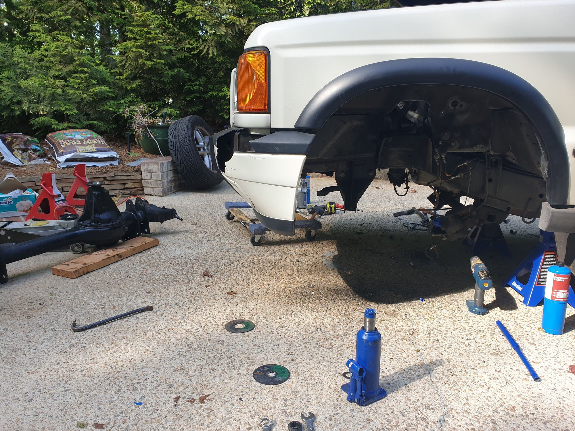

Ok, I'll try again now that the axel is out.
If not... Otherwise I can get a 'new' one in about a week.
If indeed it is bad, I've opted to pay a few $ more to get an overhauled case from Uland in FL. Anyway, since I had to tear out the front end I decided now would be a good time to replace all the bushings.
Nothing beats a propane torch and an impact wrench to get the radius arm bolts off.... Just fyi
Also going to replace all the radius arm bolts, just bc.
