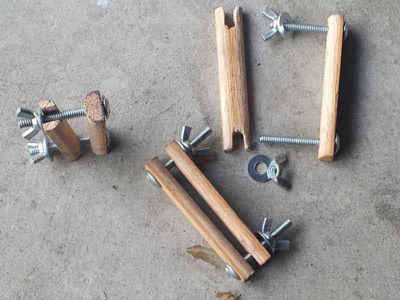

Hopefully that sheds some light on the workings of the thermostat. As for the pinch tools, I found this image on the forum and saved it- you can make your own!
That's rather brilliant. I'm going to try that with U-bolts and see how it goes.
I went ahead and bought the Britpart 180 degree thermostat and will see if I can wrestle it in in the next couple days.

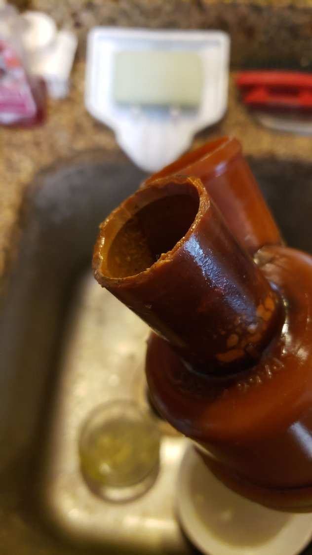

So I did some research, and apparently the way I bled it was the wrong way, which is to open the bleeder screw with the engine running. There's no waterfall sound though, and the heat seemed to improve when I topped off my coolant.
I'm also using Zerex G-05, which I like better than green coolant, but I've certainly got a schedule for flushing it.
At any rate, I took out the old thermostat, and it pretty much crumbed in my hands. The hoses appear to be new, but I'd be surprised if this was ever changed, so it was definitely time for it to go.
I'll have to drive it around a bit a rebleed it before I can call it fixed.
However, I did notice a leak coming down the outside of the radiator support. So I get to add potential cracked radiator side tank to my list.

OMG
it's supposed to be white.
As far as a cracked plastic tank on the rad, get a dremel and valley it out, fill with JBWeld, you may get a couple more years out of it.

Yeah that thermostat looks NASTY!!! I bet the T is just as brittle & I’d highly recommend replacing it.

The upper radiator hose appears to have been replaced, but I think I may have stripped the bleeder screw, which is great. I'm putting in a brass screw, and I've got my eye on the metal tee so I don't need to worry about it again.
The other thing that's baffling me, and makes me worried about the radiator, is that the coolant is going in a fairly normal yellow color, and is coming out a very clear, very bright, purple. I've flushed the system a couple times before filling it and added (I think) a UV dye, and it has none of the hallmarks of a head gasket leak, but I'm nervous that there's ATF somehow getting into the cooling system (and vice versa). That said, I was under the impression that the transmission cooler was separate from the radiator, so I'm not sure how the two would mix.
