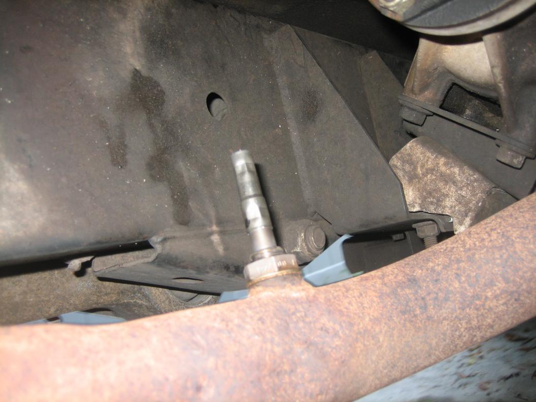

3rd mistake: after replacing the passenger side post-cat o2 sensor, I put the wire seemingly out of the way from the driveshaft (it was hanging right next to it when I found it!). I'm not sure where it was clipped into place at one point, but apparently I didn't secure it properly and by the next day the driveshaft had ripped the wire right out from the sensor (which still sits in the y-pipe). See picture of what is left.

Picture #2: what's left of my passenger post-cat o2 sensor after the driveshaft ate it.
